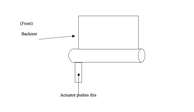

Okay so completed a similar project the other day,but I am addicted now.
I built a parallelogram binocular mount similar to this.
Now I am trying to come up with ideas for a binocular chair....like this
I would like to make the chair recline though. This is where I need help. I need to make it so goes up and down slowly (since in my design, the binos will be attached directly to the chair) , perhaps by use of a hand crank.
I was thinking of using some kind of spiral jack or something...
It needs to be cheap and the premise should be something along the lines of, I turn a crank and it raises or lowers a cylinder or something to that effect.
Any ideas are appreciated and images of those ideas too if possible.
I am also going to use a similar method to make the chair rotate about the vertical axis too.

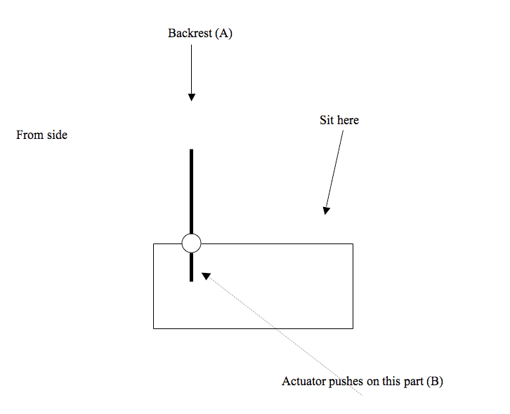

You will notice that most chairs do their reclining feature through the use of pulling a handle and allowing you to freely recline the chair while you hold that handle, and it relocks when you release it.
So what you do is you use a hinge, and you attach a ridged circle at the end, and then you attach another ridged circle that locks with the hinge, and connect it to a handle that has a pivot just before the second ridged circle, and a spring to keep it in place until moved. Then pivoting the handle will allow you to recline.
NOTE: I'll draw you a diagram and attach it in a few minutes.

Building a chair,need ideas
Actually, it would not be jagged at all, as in pulling the handle, it would release the two ridged circles, and if you add a small amount of friction between the chair and the area that reclines, the movement will actually be very smooth.
(The drawing is terrible btw, so interpret the best you can)

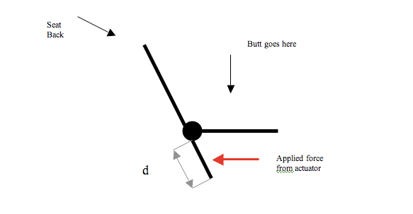

I found one online. It goes from min height of 6.4" to max height of 13.5"
I am wondering if this what the best range of inclination I can get out of this will be.
Taking the horizontal as a reference axis and sitting upright to be 90 degrees.
Sitting at 90 and laying at 0 degrees are unnecessary.
Hmmm. Time to get out some paper here to see what the compromise will be.
