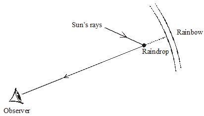

The diagrams below illustrate the formation of a rainbow. Figure 1 shows the general arrangement and Figure 2 shows the path of a ray through a raindrop with the centre of the raindrop is labelled O.
Figure 1:

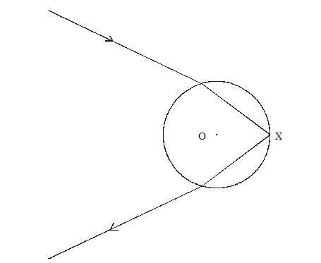

Figure 2:

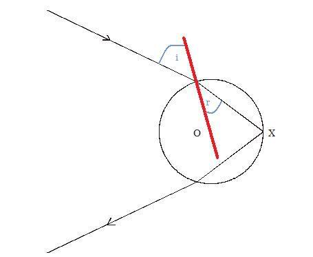

a.)
Where the ray enters the raindrop in Figure 2, mark the angle of incidence i and the angle of refraction, r.
b.)
Figure 2 is drawn to scale. By taking suitable measurements, show that the refractive index of water is about 1.3.
[itex]\mu = \frac{\sin i}{\sin r}[/itex]
a.)
^ Have I labelled it correct?
b.)
I measured the angle that I have labelled above and got [itex]i = 25^\circ[/itex] and [itex]r = 35^\circ[/itex] and this gives [itex]\mu = 0.74[/itex]. This is incorrect. The correct answer is [itex]i = 53, \ r = 39, \ \implies \mu = 1.27[/itex]. Where have I gone wrong here?

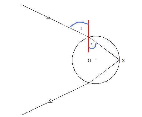

The normal should be perpendicular to the water's surface.
So, is it like this?

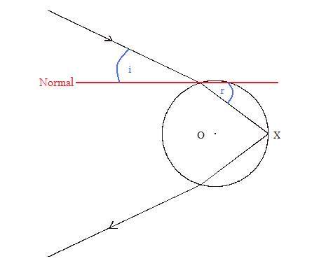

Or, is it like this? :confused:
You just seem to be drawing random lines lol...
The normal line on a spherical surface at some point P is always the line that goes from P through the center of the circle.
In other words; if you draw a straight line through the center of a circle, then at the points where it intersects the circle the angle between the line and the circle (at that point) is exactly 90 degrees, or perpendicular.
Oooh, I understand now. I guess it is this:
Am I correct?
Yes, that looks good.
