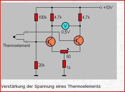

See "Voltamp.jpg" please. It doesnīt work, two wires of different materials, united at the one end, if you touch that point the voltmeter should amplify the 0,001 Volt that is caused by the different temp.
Donīt know your terms Notime, sorry, and transistor amp. with AC donīt wanna study. I am doing DC, stop.
Ciao.

Welcome to the PF, Ciani. That is a differential amplifier that should give you a differential output voltage that varies with the thermocouple temperature. What voltages do you measure at the various nodes in the circuit?

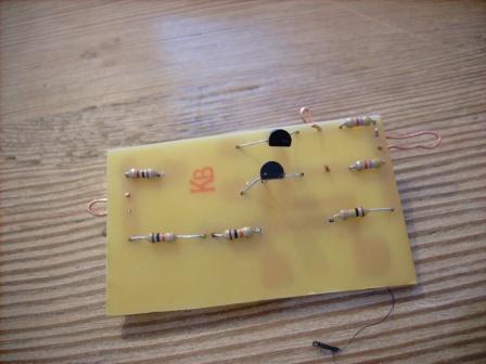

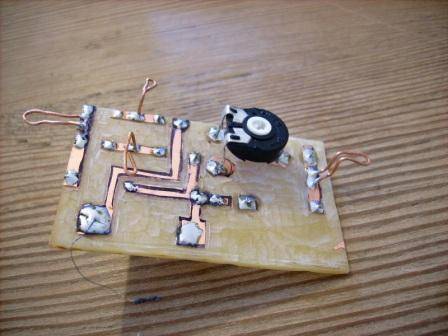

The circuit should measure 1 mV changes.
One of the two wires during transport has gone broken, transistors are type B547C but I donīt think it is relevant by such a circuit.

At this point, I'm not sure what your question is.
You can use the schematic you posted before as a guide to reconnect the wire.
