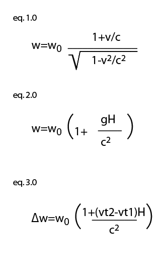

Two clocks in a gravitational field separated by an altitude of x, exhibit constant time dilation.
Two clocks accelerating in free space separated by the length x of their ship, exhibit non-constant time dilation.
How is the principle of equivalence sustained when this fundamental measure of acceleration differs?
Two clocks in a gravitational field, separated by any height - will not experience the same acceleration - nor the same dilation.
That's true, but not my question.
1) A clock at a height x above the Earth's surface will run faster than an identical clock directly below it on the Earth's surface as measured by the latter.
2) A clock at the front of an accelerating frame will run faster than an identical clock directly behind it (on the axis of motion) in the same frame as measured by the latter.
The time dilation in 1) is constant. i.e. the difference in "rate" of time measured between the clocks is the same no matter when it is measured.
The time dilation in 2) is non-constant. i.e. the difference in the "rate" of time measured between the clocks "increases" over time.

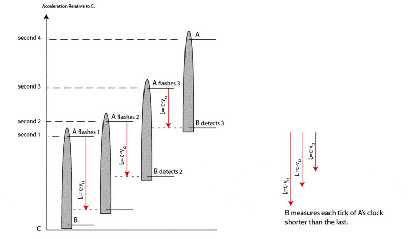

Let me make it clear.
A rocket-ship stands upright on the Earth. We will call the front of the ship A and the back B.
We synchronize clocks, call them Ac and Bc and then place them at A and B respectively.
A clock "Ac" at the front of the ship "A" is designed to emit a flash of light at regular intervals toward B (let's say once per second).
An observer at the back of the ship (B) is marking the frequency of the signals (i.e. the time intervals between each flash)
against their clock Bc.
In a gravitational field, the observer at B will measure the light signals to arrive at a greater frequency than once per second according
to their clock Bc. This is gravitational time dilation.
When the ship is accelerating in free space, (let's say relative to the Earth) the observer at B will again measure an increased frequency
of the signals which they can only reconcile as follows:
The speed of light is constant, the length of the ship (x) is constant, therefore x/c is constant, therefore the clock at A is running faster than
the clock at B. This is the equivalence of gravitational time dilation
In a gravitational field, such as when it is standing on Earth, the clock at A, will remain at a constant rate of time that is faster than the
clock at B.
When accelerating, the clock at A will continue to increase its rate of time with respect to B as the ship's instantaneous velocity
relative to the Earth, increases with its acceleration. Why, because relative to the Earth and for the same reason Ac is fast in the
first place, the distance between the emission at A and detection at B decreases over time with the constant acceleration of A,B.
The constancy of the speed of light (i.e. independent of A and B) will result in a constantly decreasing time of detection at B between each signal.

When the ship is accelerating in free space, (let's say relative to the Earth) the observer at B will again measure an increased frequency of the signals which they can only reconcile as follows: The speed of light is constant, the length of the ship (x) is constant, therefore x/c is constant, therefore the clock at A is running faster than the clock at B.
Woa there! Where did you get the idea that the speed of light is constant in a gravitational field. In fact it isn't. It is a function of position.
This is the equivalence of gravitational time dilation In a gravitational field, such as when it is standing on Earth, the clock at A, will remain at a constant rate of time that is faster than the clock at B.
Okay so far (except for the speed of light in a g-field).
When accelerating, the clock at A will continue to increase its rate of time with respect to B as the ship's instantaneous velocity relative to the Earth, increases with its acceleration.
I disagree. The rate at which the clocks tick will remain constant as measured in the ship's frame of reference. Why do you think that the rate will increase. Please state with what frame of reference you are referring to when you use the term "increase".
Why, because relative to the Earth and for the same reason Ac is fast in the first place, the distance between the emission at A and detection at B decreases over time with the constant acceleration of A,B. The constancy of the speed of light (i.e. independent of A and B) will result in a constantly decreasing time of detection at B between each signal.
With what frame of reference are you referring to when you say that the distance increases. Also recall that the speed of light is not constant in a g-field but varies with position.

You're right the "speed" of light is not the "same" in all positions, but it is constant at each position. It's constancy at B is all that's needed to calculate the rate of signals from A.
The rate at which A ticks will remain constant as measured by an observer "at" A and the rate at which B ticks will remain constant as measured by an observer "at" B.
That is not the issue here.
The rate at which A ticks according to the measured rate of signals detected at B must increase with the increased velocity of the ship with respect to the Earth.
You seem to be agreeing with the experimental mechanics in principle and then questioning the mechanics you agree with.
If you agree with the principle of equivalence of acceleration and gravitation what do you think is the means by which a clock at A is detected to run faster than a clock at B in an accelerating frame?

I am going to attempt to post an image that should make my point clear. Please let me know if we are still talking about the same experiment.
Okay. It looks like we're talking about the same thing.
Best regards
Pete
That is a very nice figure!
You still haven't derived anything. None of your verbal arguments nor this excellent diagram prove that the time dilation is non-constant as measured by B.
I also think you still fail to understand that the equivalence principle relates a gravitational field to an accelerating reference frame, not an inertial one. Your frame C is inertial and so it is completely irrelevant to the discussion about the equivalence principle.
