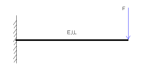

its not a question it is a part of a physics assignment of beam deflection.. i am trying to show for the formula (force x length^3)/(4 x young’s modulus x breadth x thickness^3) was derived. i know it was done through integration and the combining of the bending moment formula and the Torque formula (T=fr)...

Suppose we have the situation in the picture.
Click image for larger version
We get:
[tex] EIv_{xx} = -FL+Fx [/tex]
or after two integrations:
[tex] EIv(x) =F \frac{(x-L)^3}{6} +C_1x +C_2 [/tex]
From this point on I leave it to you....

Amy54 wrote: "What is the bending moment formula?"
d(theta)/dx = M(x)/(E*I), where theta = beam rotation, and M(x) = moment as a function of x.
Amy54 wrote: "Is it related to the pure bending formula? What's that? Is the formula 1/rho = M/(E*I)?"
Nice work, Amy54. Yes, that is the pure bending formula. For small theta, d(theta)/dx = 1/rho.
