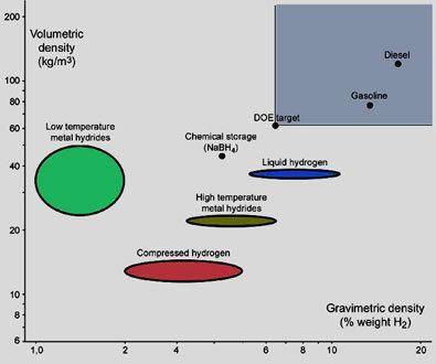

I would like to know how Hydrogen compares to gasoline or diesel fuel for BTU which is the basic comparison for energy sources. If water is relatively easy to get, then the cost of hydrogen production is irrelevant. but gasoline on the other hand is expensive and controlled by a few individuals.

This source mentions that hydrogen gas contains 61,000 Btus of latent energy per pound compared to regular gasoline which has 20,500 Btus per pound. Of course it also mentions that a pound of hydrogen gas takes up about 10,000 times the space that gasoline does...:
http://mb-soft.com/public2/hydrogen.html
Making Hydrogen gas from water to use as a fuel is much more expensive than simply using fossil fuels to do the task (the above site does a good job of explaining why)...the only real benefit over using gasoline is that you do not have pollution when burning hydrogen.
