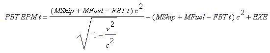

I had made a model assuming a relativistic rocket accelerating with constant power,variable acceleration,variable total mass the result however is somehow counterintuitive. The less exhaust velocity the rocket have, the higher terminal velocity it will have.
Is that means I did something wrong ?

I have to modify the equations though, since what I want is a model with :
- constant wattage
- constant exhaust velocity relative to the ship (is this the one called proper exhaust velocity)
- variable proper acceleration
- variable coordinate acceleration
The equations used is attached as 2 jpg images :
Mass Energy Conservation equation :
PBT*EPM*t = (MShip+MFuel-FBT*t)*c^2/(1-v^2/c^2)^(1/2)-(MShip+MFuel-FBT*t)*c^2+EXE
Linear Momentum Conservation equation :
(MShip+MFuel-FBT*t)*v/(1-v^2/c^2)^(1/2) = EXE/EXV
The variables used is as follow :
PBT : Mass of Fuel burned per unit time
EPM : Fuel Potential Energy per unit mass
MShip : Rest Mass of the Ship
MFuel : Rest Fuel Initial Mass
EXE : EXhaust Energy
EXV : EXhaust Velocity
The complete derivations I used is attached as mws file.
Thank you.

Oh I just remember that. Guess I will have to learn more English Physics Vocabularies.
Btw what I mean is the highest velocity the rocket would reach after using some part of its fuel to accelerate itself, provided that the rocket should have enough fuel to decelerate and arrive at its destination.
