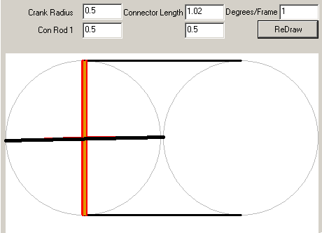

I got curious about a single stroke engine design that popped into my head and made the attached animation. .
It does not look to me like it would have any use but curiosity value. In fact it does not appear to have any redeeming features whatsoever - two crankshafts that speed up and slow down so gearing cannot connect them, valving would be horrendous, it just doesn't look like it would be efficient etc etc.
However it should work, and it can sort of be said to to be One-stroke, "sort of" probably being a very important qualification.
Note that the animation is with the left hand crank running at a constant rotation and that the right hand crank speeds up and slows down during one rotation.
I have searched the net looking for anything similar but can't find anything. Has anybody seen similar and what are they called?

looks nice, but what would you have your variable speed shaft do?

I do not have a clue.
I thunk this up on Thursday 31st July, did the calculations in the attached spreadsheet on Friday, and did the conversion to code and graphic in VB on Friday night.

A more fundamental question remains firstly though. On Sunday I ascertained that the design has two possible firing cycles, it can either fire at the end of the stroke (as shown in the animation) or during the compression in the middle of the stroke. Firing in the middle of the stroke seems to have an advantage. As the connector length increases the gap between the pistons increases, but it increases differently for the middle compression and the end compression. The gap between the pistons at the end compression seems to be only 50% of the gap for the middle compression.
In a current ICE there always remains an amount of burnt gases in the head space, the cylinder is never fully evacuated. This head space is the combustion chamber, so with a compression ration of 10:1, 10% of the gasses in the chamber at ignition have already been burnt.
With this design if the middle compression is set to a 10:1 compression the exhaust stroke at the end of the cylinder will leave only half of the burnt gases. In the spreadsheet this is with a connector length set to 1.58. Curious
I was looking at the animation again and it seems to me that this would be a fairly noisy and quite possibly short lived engine. Look at the amount of sideways pressure that is put on each piston during the cycle. The piston seems to come to a rest and start back up again quite suddenly. Experimenting with the connecting rod and connector lengths I am sure would yield some interesting results.

It isn't actually a "single stroke" engine in the first place, it has the standard strokes of a 4-stroke engine (intake, compression, combustion, exhaust). It's basically a single cylinder engine.
The gif file shows a moving animation, but the path followed by the piston and "connecting rods" would be impossible to fabricate, and wouldn't make any useful torque or power.
So it undertakes the four functions of intake, compression, combustion and exhaust. A two-stroke engine undertakes two of the four functions in one stroke, a four stroke engine undertakes one function in one stroke. The single stroke undertakes the four functions in one stroke.
I do not believe it is impossible to fabricate, it is a simple 2D drawing that shows the functionality and shows it can be fabricated.
I have no idea whether useful torque would be produced, some torque would be produced, whether it is sufficient to keep the engine going I have no idea.
I don't think this engine would run any cycles at all. It will just settle in the middle and start violently shaking.
As does any engine without a fly-wheel
No there is a fundamental difference here. The only reaction force to the piston expansion is the inertia of the piston itself.Unless you make it super heavy, you can't use the power cycle effectively. If its that big, its useless anyway. It will tend to quickly settle in the middle and try to expand towards both sides and collapse back.
