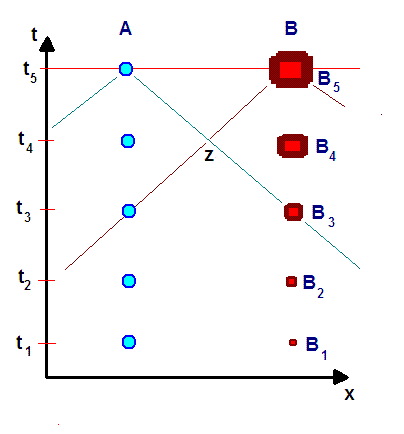

Essentially if I took a series of 2 dimensional images of “now” and stacked them in chronological order, I create a “time loaf”. (I am aware that it is in fact not 2D but it certainly makes it easier to mentally process)
As you raised the idea of a "time loaf", the thing you need to know is this: each observer slices their bread in a different direction!
See diagram at bottom of this post.
Two events are simultaneous, according to an observer, if they are in the same slice. But as their slices are at different angles, two observers disagree what "simultaneous" means.
Each observer calculates the other observer's clock rate as the rate of "blobs per slice" (in the diagram), using the other observer's blobs but their own slices. (Let's say each blob represents a one-second tick of a clock, and each slice is one second thick.)

I think you're misunderstanding the "time loaf" concept, i.e. the idea of slicing up 4D spacetime into a series of 3D slices. The slicing is not based on when you see images of events--i.e. if your clock reads 12 noon, August 5 2008 at the same instant you see a distant star going nova, the event of your clock striking that time and the event of the nova would not be part of the same "slice". Instead, slices are collections of events that are assigned the same t-coordinate in your rest frame. One way of thinking about this is in terms of your compensating for the delays in images reaching you, under the assumption that light always travels at exactly c in your frame; for example, if that distant nova was exactly 100 light years away in your frame, then since you saw it at a time-coordinate of 12 noon, August 5 2008 according to Earth clocks, the event itself would be assigned a time coordinate of 12 noon, August 5 1908, and thus be simultaneous with events on Earth at that date--part of the same "slice".
As DrGreg said, a key idea here is that different frames slice the same time loaf at different angles, which is another way of saying they disagree about the simultaneity of different events--if two events at different locations are assigned the same t-coordinate in my frame, they may be assigned two distinct t-coordinates in the frame of an observer in motion relative to me. This has to do with the fact that each observer assumes light moves at c in all directions relative to themselves. So for example, if I am on a spaceship which I treat as being at rest, and I set off a flash at the midpoint of the ship, and light-detectors at either end of the ship will click when they detect the light from the flash, then in my frame the light moves at the same speed in both directors so the two clicks are simultaneous. But if in your frame the ship is moving forward, that means in your frame the detector at the front of the ship is moving away from the point where the flash went off and the detector at the back is moving towards it, so if you assume the light moved at the same speed in both directions in your frame, naturally you must say that the click from the light detector at the back of the ship went off before the click from the light detector at the front.
I think I am saying the same thing as you JesseM but perhaps a little less eloquently. To illustrate how I mentally envisage the time loaf, I have drawn a simple diagram.
For the purpose of simplicity I will ignore all 4 dimensions of space and only use time (y axis) and distance (x axis). On the x-axis we have two objects (A and B) which are represented at 5 distinct time points t1-t5. There is no relative velocity between objects A and B.
For the time loaf represented, I am looking at these two axes as a “superbeing” (I don’t know how you refer to an all-seeing being that is immune to time dilation etc. so a “superbeing” will have to do for now) Therefore I, the superbeing, can see the true reality… that at t5 objects A and B are actually in states A5 and B5.
However, at t5, objects’ A perception of reality will transect the loaf at an angle that is proportionate to the speed of light. Object A will therefore see object B in stage B3. Object A will believe this to be a true reflection of t5 from its perspective (ie B3 occurs at t5). (I presume that in 3 dimensions object A transects the loaf in a conical shape but that the cone would be perceived as a flat surface by object A – is this what is referred to as “warping of space”?)
Similarly object B will create a conical time slice of the time loaf such that it would believe that object A is in phase A3 when Object B is in t5. Thus at t5 neither object A nor object B will agree on “reality.” The only thing that they will agree on is an event or object at z as z is equidistant from A and B and the point at which the two cones (time slices) transect.
Is this correct?
