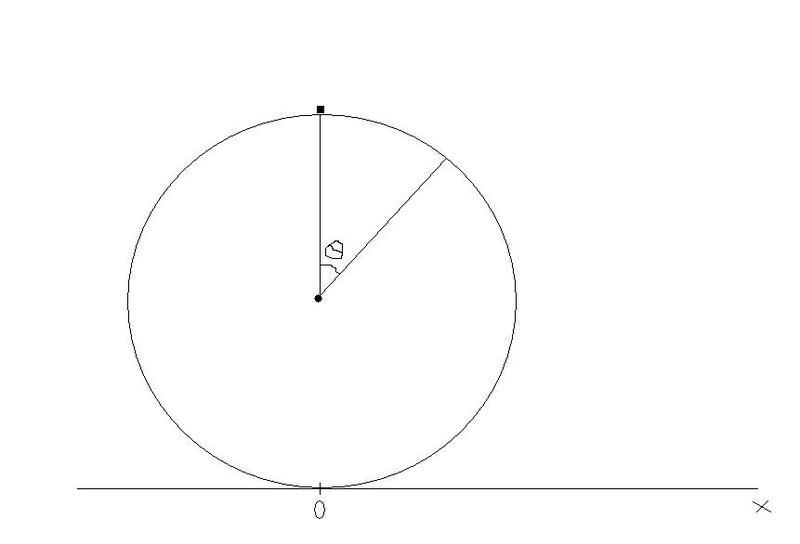

Consider a frictionless sphere of radius r=5.0m that is fixed to the ground and a small block of mass m=1.0 kg that is nudged slightly from the very top. This takes place on the surface of the Earth. Find the location on the ground where the block lands by following the steps below: I have drawn the item using Paint, and I'm attaching an image of it:
a. Find the numerical value of the angle at which the block leaves the sphere.
b. What is the velocity of the block at the instant it leaves the sphere? (Note the components)
c. Find how far from the sphere's point of contact with the ground (0 on the diagram) the block hits the ground.
F=m*a
g=9.81 m/s^2
KE+PE=constant
KE=.5*m*v^2
W=F*d
W=change in KE
v^2 (final) = v^2 (initial) * 2a*delta X
Well, what I thought was that, since there is only a tiny nudge in the horizontal direction, the velocity in that direction is basically ignorable. Thus, the block will accelerate straight downward along the path of the sphere until it hits an angle of 90 degrees, at which point it will continue to fall straight downward.Thus, here is my answer solutions:
A) angle=90 degrees
B) I plug into the equation relating v^2 and 2a*deltaX. In this case, v^2 initial=0, a=9.81, and delta X=5 meters. When those are plugged in, I get the final velocity to be about 9.905 m/s.
C) Because the mass fell at the angle of 90 degrees, it feel straight down, meaning the distance from the point of contact is simply the radius of the sphere, which is 5m.

While you do not impart any x velocity at the start, the block does develop velocity in the x direction doesn't it as it slides along the surface of the sphere? How would you account for that horizontal velocity? Setting it to 0 doesn't seem right does it?
You are right that once the block loses contact with the sphere the y component will be at free fall g.

No, it will leave the sphere when the reaction force is zero, which is well before 90º.
(if it was still clinging on at 90º, it would have lost all the sideways velocity it had picked up, wouldn't it? :wink:)
So how can you work out the reaction force? :smile:

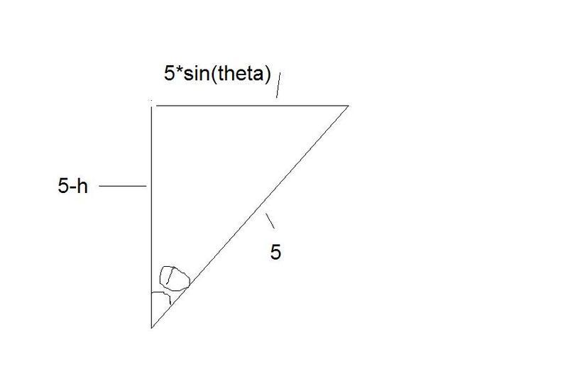

Secondly, I'm assuming that h is the height fallen, and R is the radius, which is 5 m in this case. Thus, R-h = distance fallen. I could also set up a triangle such that the vertical side is 5-h, the hypotenuse is 5, and the horizontal side is 5*sin(theta). I'll attach a drawing of what I'm thinking of:

As for your drawing - No need. It is R*sinθ .
Armed with that and the work/ke relationship and the relationship for the reaction force that Tiny-Tim was directing you toward, you might be in a position to resolve things?

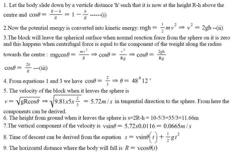

Dear everyone, thanks for all the help. Taking your advice into consideration, I think I've solved this now. I've attached the steps I took as a pdf and a jpeg. The pdf is probably easier to read: Can you please check for any errors I have made? Thanks you
Hi Darkalyan! :smile:
(No … the jpeg was large and clear.)
Very good, except for two numerical errors …
in 6.: 10 - 5/3 ==25/3, not 35/3
in 7.: where did you get that value for sinθ?
Also, your 1. is very confusing … it looks as if yu're trying to fix h. Better would be "when the block has moved through an angle θ, its height has fallen by R(1 - cosθ)."
But the method is fine … you obviously understand it now! :smile:
