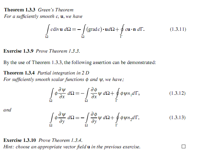

I don't know how to choose u. I presume we look in 2D; I thought u should look something like:
[tex]u = \left[ \begin{array}{c} \psi \\ \psi \end{array} \right][/tex]
and [tex]c= \phi[/tex] but that isn't correct.
How about picking two vector fields? Pick u=(psi,0) for the first part and u=(0,psi) for the second part.
Yes of course, thanks Dick!
