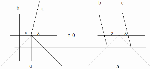

2.One reason why acceleration is not relative or symmetrical is shown in the drawing.
If observer (a) changes velocity, he perceives the rest of the world (b,c) to
change instantaneously. If the rest of the world changes velocity instantaneously
(to mirror his perception), objects would have had to start moving at historical
times, proportional to their distances.
