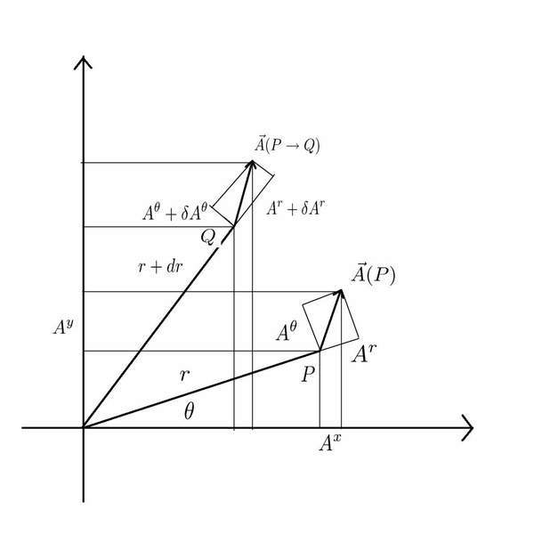

When you rotate passivly an arbitrary vector in [tex]P[/tex] (which is not in the origin of a coordinate system), you will get the following new coordinates for the same vector:
[tex]x'=x \cos\theta+y\sin \theta[/tex]
[tex]y'=\frac{1}{r}(y\cos \theta-x\sin\theta)[/tex]
where [tex]r[/tex] is the distance from the origin to the point [tex]P[/tex] and [tex]x,y[/tex] are the components of the vector. Can somebody explain me, why you have to divide by [tex]r[/tex] in the second equation?
You don't! For one thing, there is no "r" in the original information- unless you are assuming that r is the length of the vector <x, y>. But, in any case, there is no "r" in the correct formulas:
[tex]x'= x cos(\theta)+ y sin(\theta)[/tex]
[tex]y'= y cos(\theta)- x sin(\theta)[/tex]
which are simply what you give without the "r".
You can check by taking x= 2, y= 0 and rotating through [itex]\theta= 90[/itex] degrees.
Assuming, again, that r is the length of the vector, then here r= 2 and your formulas give x'= 2(0)+ 0(1)= 0, y'= (1/2)(2(1)- 1(0))= 1 but <0, 1> is a a vector with length 1.
Using the formulas without the r, you get x'= 2(0)+ 0(1)= 0, y'= 2(1)- 1(0)= 2 giving the vector <0, 2> which is correct.
I attached the graphic which describs the situation with the rotation. What I want is to describe the vector in the lower part of the system in coordinates of [tex]A^{\theta}[/tex] and [tex]A^{r}[/tex]. The professor told me that the solution is:
[tex]A^{r}=A^{x}\cos\theta+A^{y}\sin\theta[/tex]
[tex]A^{\theta}=\frac{1}{r}(A^{y}\cos\theta-A^{x}\sin\theta)[/tex]
The first component is simply a rotation, but why this factor [tex]\frac{1}{r}[/tex] in the second component?

Why don't you ask the professor?
