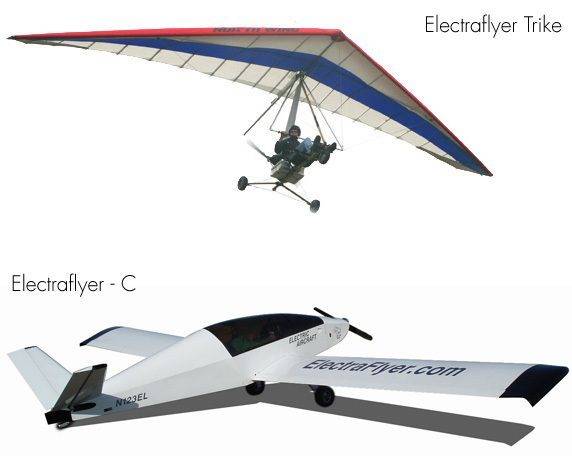

How about the Trike?
http://electraflyer.com/"

Surprised the power/weight for batteries is good enough - it looks like the lightweight low speed prop is the real breakthrough.
I wonder if you could put a few m2 of solar panels on the wings and give the range a boost.
That calculation is relatively easy: A good solar panel can generate 140 w/m^2 at noon. The batteries on that plane hold 5.6 kWh and can power the plane for up to 2 hours (2.8 kW). If the wing area is 10 m^2 (it is probably less), in 2 hours, it would generate enough energy to keep the plane flying another hour.
This, of course, assumes the sun is high in the sky and doesn't take into account the weight of the panels or electronics, which would be substantial...
I thought (it's too early here for calculations) it was impractical because the solarplanes are ultra-light NASA carbon fibre things. So I was surprised that the battery on this worked.
Although - this is likely to be mainly used in areas with nice weather (SW USA). It might be worth having a m^2 of solar panels just to re-charge on the ground, so it's charged for the next days flying.
