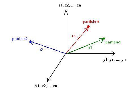

Dear Hurkyl and shouvikdatta8, thanks for your answers.
I think I've now understood something. I now think something like the picture attached to this message. Is this picture correct?
Psi(r1, r2, ..., rn) gives the combined "AND"ed probability.
Regards
Regards
Now you're getting there...
