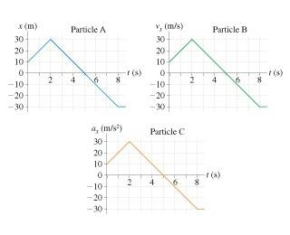

The problem is, to find velocity at a given time (t=5 sec) on a acceleration v time graph.
I think the area under the curve represents the average velocity, but I really do not know how to find the velocity at THAT given time.
*Note: I included a picture on the bottom, I tried to find the area under the curve but did not come up with the correct answer. It is the graph labled Particle C

area under the curve is the velocity.
You either
1. Integrate acceleration up to t=5 if acceleration is given as a function of t OR
2. Find the area under the curve within t=0 and t=5 inclusive
attachment is included.
85 ms-1 is incorrect?
