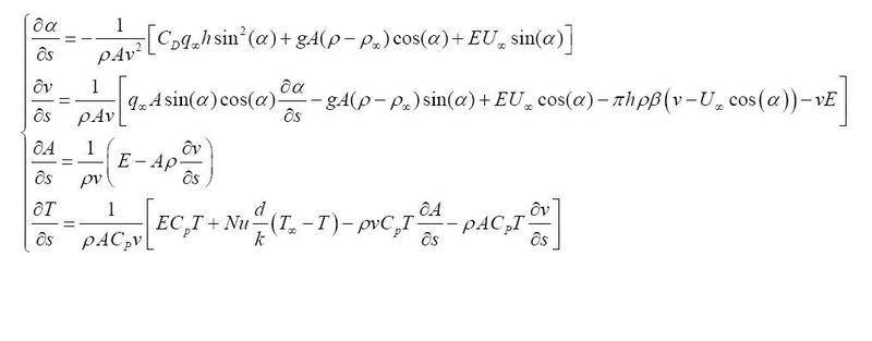

Allamarein
Let's suppose I know every coefficients this script:
and
y1 alfa
y2 v
y3 A
y4 T
function dy=isaacsimply(s,y)
dy = zeros(4,1)
global ...
dy(1)=(Cd_for*q_inf*h*(sin(y(1)))^2+...
g*y(3)*(rho-rho_inf)*cos(y(1))...
+E*U_inf*sin(y(3)))/...
(-rho*y(3)*y(2)^2); %dalfa
d_alfa=(Cd_for*q_inf*h*(sin(y(1)))^2+...
(-rho*y(3)*y(2)^2);
dy(2)=(q_inf*y(3)*sin(y(1))*cos(y(1))*d_alfa...
-g*y(3)*(rho-rho_inf)*sin(y(1))+...
E*U_inf*cos(y(1))-...
pi*h*rho*beta*(y(2)-U_inf*cos(y(1)))^2-...
y(2)*E)/(rho*y(2)*y(3)); %dv
d_v= (q_inf*y(3)*sin(y(1))*cos(y(1))*d_alfa...
dy(3)=(E-y(3)*rho*d_v)/(rho*y(2)); %dA
d_A=(E-y(3)*rho*d_v)/(rho*y(2));
dy(4)=(E*Cp*y(4)+Nu/d*k*C*(T_inf-y(4))...
-rho*y(2)*Cp*y(4)*d_A-rho*y(3)*Cp*y(4)*d_v)...
/(rho*y(3)*Cp*y(2)); % dT
This script solves the system.jpg?

I'd use Runge-Kutta on this one as long as you know the initial conditions...
ICs:
y1=pi/2;
y2=51.6;
y3=1.96e-7
y4=300
I'd know my transposition from mathematical problem to Matlab is correct. My results tell me I am wrong.
At a quick look what you have listed as d_v is actually y(2)...
You also must look and see how well conditioned your functions are, i.e. your initial conditions are orders of magnitude different...That makes a huge difference in how well the solution is calculated.
d_v=dy(2);
I used this expedient because I thought typing dy(2) directly, Matlab uses that dy(2) and not that calculated at precedent step. In a word it is a complicated story, but now I suppose defining d_v is useless.
You'd be right, but these are my ICs. I supposed Matlab should give a warning (i.e an out tollerance value) if it finds troubles. If Matlab gives me a solution, I should trust that is correct (and fortunately I don't)
Anyway, maybe should I try to convert my system in a dimensionless one?
Your equations are highly nonlinear, there are many issues with getting a robust solution. Linearize them to get a 1st order, then add in layers of complexity to ensure you don't get off track.

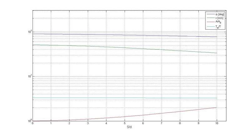

I tried to use your wise hints.
I used taylor series for trigonometric functions
[tex] \eqalign{<br /> & \sin \left( \alpha \right) \approx 1 - {1 \over 2}\left( {\alpha - {1 \over 2}\pi } \right)^2 \cr <br /> & \cos \left( \alpha \right) \approx - \alpha + {1 \over 2}\pi \cr} [/tex]
I didn't discover a large difference.
I uploaded results for the case with taylor expansion and for the "exact" system.

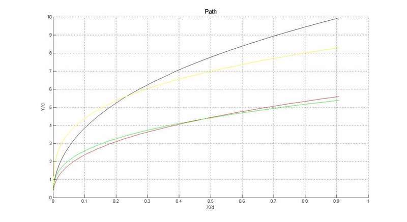

The path.jpg is another story:
when I calculated [tex]\alpha[/tex] I can plot my path in X-Y plane, moving of a [tex]ds[/tex] in the direction suggested from the angle.
[tex]X\left( i \right) = X(i - 1) + \cos \left( \alpha \right)ds[/tex]
[tex]Y\left( i \right) = Y\left( {i - 1} \right) + \sin \left( \alpha \right)ds[/tex]
Black line is the path born by ODEs
Yellow,green and red paths are calculated with correlation equation or read from reference.
Black line should be similar at the red one ultimately.

Now your getting there, keep plugging along, you've made progress.
