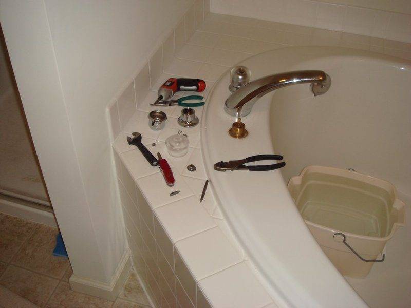

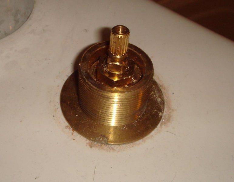

I have a tub in my bathroom that I have yet to use (I have a separate shower next to it), but it has recenly developed a 30 second drip that I can hear while lying in bed. It's driving me nuts. I've turned off the water and tried to take apart the valve, but can't seem to get it completely apart. And I have no access to the underside. Kohler is no help at all - their faucets don't leak, so why provide information on fixing them?
The stem turns freely when you take off a guard, but I'm not sure if it'll just pull up. I'm tempted to stick a screwdriver up under that hex-nut looking structure and go at it, but of course if I break something, I'm screwed.
My water here is so hard it was off the scale (no pun intended) when I did a test. It corroded my other shower's mixing valve stuck (I scalded a couple of friends who stayed over a few months ago), but I was able to get at that from the front to take it apart and clean it.

I'm really good at plumbing, but I'd have to look at it up close. If this is one of those washerless faucets, you may have to just replace it.

That hex-nut looking thing is the part you turn to unscrew the faucet innards. I actually have a nifty little tool that fits over one of those perfectly, since it's hard to get a wrench down over it with the stem in the way. (The tool came with a replacement faucet I bought once upon a time...if I lived closer, I'd let you borrow it, but I think you could buy your own for far less than the cost of gas to drive here to get it. :biggrin:)
Once you get that part off, everything else should start looking like familiar faucet parts underneath, including whatever sorts of o-ring type thingamabobs need replacing to stop the leak.
Until you have time to start playing with the faucet, maybe sticking a towel in the tub under the drip would be quieter than letting it hit the tub surface? I'm not sure, I've never actually tried it. Or else, you could just close the bathroom door at night. Or would that mean you'd walk into the door if you got up in the middle of the night? :rolleyes:

I helped my dad build a deck, and finish an entire basement. Did anyone notice the TWO hex bolts? Seems like they are locking. If you hold one fixed and loosen the bottom one it should come out.

Where do you see two hex bolts? The smaller SQUARE thing (not a hex bolt) on top of the hex NUT (aren't you guys the engineers?) is part of the stem that turns the water on and off. Just the big nut needs to be unscrewed to get at everything under it.

I did get a hex driver over it and applied a decent amount of torque to it, but it didn't turn and I'm afraid to apply more for fear of flooding out my house.

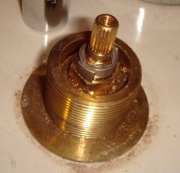

It seems with the stop removed, I can turn the valve a few degrees further and the water stops. I don't really want to have a freely spinning knob, but I might have to live with it.

I don't know what Cyrus is, but you're right - the square thing is part of the stem and spins freely. A little steel part fits on it to catch on the stopper tabs to keep the knob from spinning freely.

Photo with the mechanical stop installed...
Incidentally, I have my main water valve on now and I'm not getting a drip, even with the stem turned to the stop (not past the stop). Maybe it just needed a good talking-to?
The inner shaft spins freely?
What about that lower bigger hex bolt? Did you loosen that?

That's the one I got a nut driver over and applied a bunch of torque to. I heard some creaking, but it didn't break loose - I'm not even sure it is supposed to.

Sometimes that's all they need. Since you said you had problems with things getting stuck with hard water deposits, maybe just fussing with it broke some crud loose? I've fixed things that way too...take it all apart, stare at it, decide I'm not sure what exactly I need to do to fix it so put it back together to work on another day, and it suddenly decides to work. Maybe it's a placebo effect.
I took the handle off the one in the master bath and i looked online. They seem to have something (similar) to your bottom big hex nut that needs to be undone. Try taking it off on the OTHER one. It might come off easy. Also, spray some WD40. I had to change my wiper blades in my car and one just wouldn't come off from rust. I sprayed it and it popped right off.
