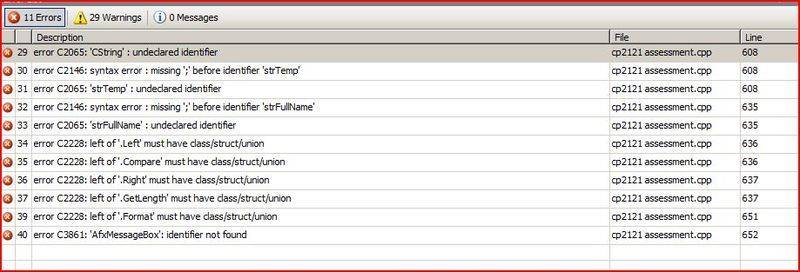

31si
Hello
Just a quickie. could anyone tell me which header file i have to include to be able to use CString in VC++? I have looking on the net and I can't find one that works. One suggests to use AFX.h but I get more errors with that included than without it.
Technology news on Phys.org
CString is defined in afx.h
your errors maybe because you include also windows.h
if you include any MFC headers (afx.h), don't include windows.h
if it doesn't solve your problem, tell what errors you got...
I've included the file you mentioned and I still get the same error.
The attachment is a screen shot of the errors.
Can anyone make sense of them?

It would be more helpful if you'd post the actual source you're trying to compile.
Here is the code:
Code:
void IPaddress(){
	CString strTemp;
	struct hostent *host;
	struct in_addr *ptr; // To retrieve the IP Address
	DWORD dwScope = RESOURCE_CONTEXT;
	NETRESOURCE *NetResource = NULL;
	HANDLE hEnum;
	WNetOpenEnum( dwScope, NULL, NULL, NULL, &hEnum );
	WSADATA wsaData;
	WSAStartup(MAKEWORD(1,1),&wsaData);
	if ( hEnum )
		DWORD Count = 0xFFFFFFFF;
		DWORD BufferSize = 2048;
		LPVOID Buffer = new char[2048];
		WNetEnumResource( hEnum, &Count, Buffer, &BufferSize );
		NetResource = (NETRESOURCE*)Buffer;
		char szHostName[200];
		unsigned int i;
		for ( i = 0; i < BufferSize/sizeof(NETRESOURCE); i++, NetResource++ )
			if ( NetResource->dwUsage == RESOURCEUSAGE_CONTAINER && NetResource->dwType == RESOURCETYPE_ANY )
				if ( NetResource->lpRemoteName )
					CString strFullName = NetResource->lpRemoteName;
					if ( 0 == strFullName.Left(2).Compare("\\\\") )
						strFullName = strFullName.Right(strFullName.GetLength()-2);
						gethostname( szHostName, strlen( szHostName ) );
						host = gethostbyname(strFullName);
						if(host == NULL)
							continue;
						ptr = (struct in_addr *)
						host->h_addr_list[0];
						// Eg. 211.40.35.76 split up like this.
						int a = ptr->S_un.S_un_b.s_b1;  // 211
						int b = ptr->S_un.S_un_b.s_b2;  // 40
						int c = ptr->S_un.S_un_b.s_b3;  // 35
						int d = ptr->S_un.S_un_b.s_b4;  // 76
						strTemp.Format("%s -->  %d.%d.%d.%d",strFullName,a,b,c,d);
						AfxMessageBox(strTemp);
    delete Buffer;
    WNetCloseEnum( hEnum );
WSACleanup();
31si could you post the FULL set of #include lines from the top? Sometimes windows headers can do funny things if you don't #include them in the correct order.
The headers are as below:
#include "stdafx.h"
#include "CP2121 Assessment.h"
#include <stdio.h>
#include <String.h>
#include <mmsystem.h>
#include <d3d9.h>
#include <D3DX9.h>
#include <d3d9types.h>
#include <winsock2.h>
#include <iostream>
#include <windows.h>

Right, CString is defined in AFX.h. I have imported it and... I get less errors.
The next error is show below:
better Idea. I have now imported #include "atlstr.h"
And I get only one error but I think I can get around it. I will keep you up to date with advances.
Problem solved. Thank you all for all of your help you have been a tremendous help.
