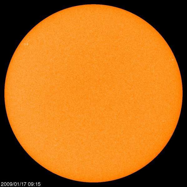

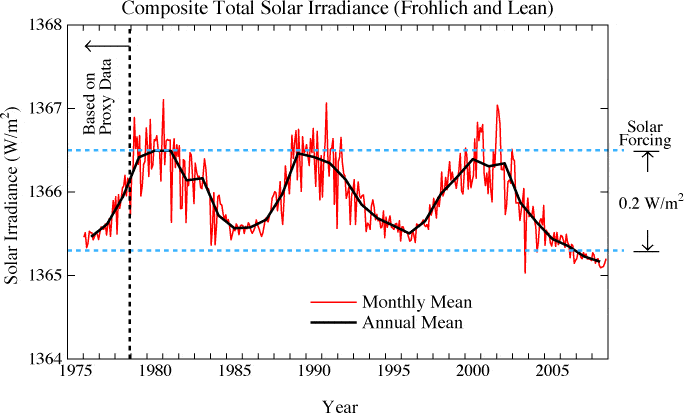

At the bottom is the latest image from SOHO and recent TSI cycles from GISS/NASA/Frochlich & Lean.
There were some sun spots earlier, but they are now gone. However, notice that at around 10:00 and 2:30 some focula are still visable. These are basically what is left over from earlier sunspots. Not sure how long they last, but my understanding is that they are what turns the spectrum more towards the ultraviolet and also increases total irradiance.
Anyhow, it looks like the next cycle has finally started. Since it is so late, I believe that tends to favor the lower predictions. Indeed, just looking at the irradiance chart from NASA and my intunition tells me the next cycle will be about half of the last one. That the experts are all over the place, suggests that just about anybodys guess is as good as another.
From NASA GISS: http://data.giss.nasa.gov/gistemp/2008/
Solar irradiance: The solar output remains low (Fig. 4), at the lowest level in the period since satellite measurements began in the late 1970s, and the time since the prior solar minimum is already 12 years, two years longer than the prior two cycles. This has led some people to speculate that we may be entering a "Maunder Minimum" situation, a period of reduced irradiance that could last for decades. Most solar physicists expect the irradiance to begin to pick up in the next several months — there are indications, from the polarity of the few recent sunspots, that the new cycle is beginning.
