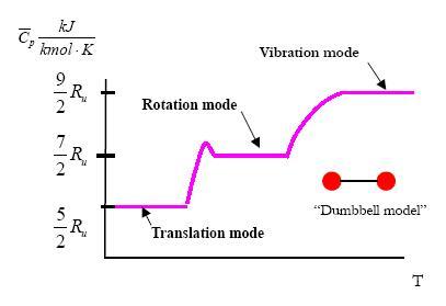

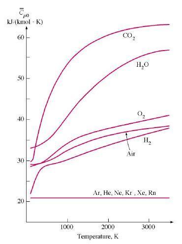

The internal energy of an ideal gas is directly proportional to the temperature. The specific heat is a function of temperature as well but can sometimes be assumed constant. The specific heats vary depending on the type of gas since they behave differently in nature. The specific heat is also dependent on the degrees of freedom. For a diatomic molecule like nitrogen the number of degrees of freedom are typically 5 (3 translational and 2 rotational). However, at high temperatures the molecule will begin to vibrate and 2 more DOF are added). Take a look at the first attachment to see a typical model of the molar specific heats as a function of DOF and temperature. The second attachment shows the specific heat (constant pressure) of various gases.

You should review the kinetic theory of gases. Temperature is a measure of the translational energy of gas molecules. It does not include vibration and rotation. The specific heats of different gases occur in large part due to different molecular moments of inertia (giving different degrees of freedom such as rotation, vibration as well as translation) and because of the principle of equipartition of energy (meaning energy is distributed equally between the degrees of freedom).
For a monatomic gas with only translational freedom, energy is all translational kinetic energy so any addition of heat adds to translational energy and, therefore, temperature. For a diatomic gas with rotational and translational freedom, some of the heat flow is absorbed by the molecules as rotational energy which does not add to temperature. So it takes more heat to increase temperature. For a polyatomic gas with vibrational, rotational and translational freedom, the heat absorption is even greater so the ratio of heat flow to temperature increase is even lower.

Different gases can have different specific heats because
a) their constitutent molecules have different degrees of freedom;
b) there are inter-molecular forces between the molecules of the gas and these forces differ between the gases;​
But if the gases have the same kind of molecules (eg both monatomic or both diatomic) and if the intermolecular forces are not significant and the volume of the molecules themselves is much less than the volume of the gas) their specific heats will be the same: [itex]C_v = NR/2[/itex] where N is the number of degrees of freedom.
