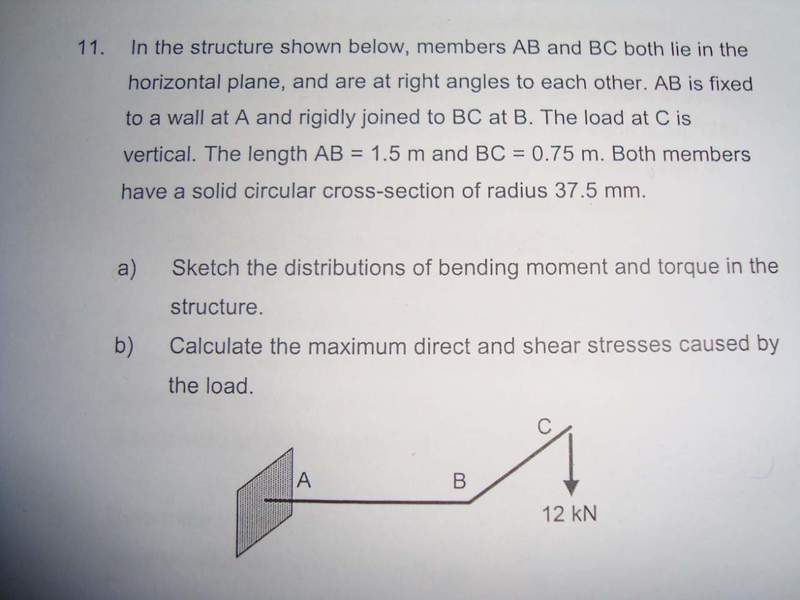

1. The problem statement, all variables and given/known data
The question is shown in the attached picture. I know how to do the first part fine,and i know how to do the second part but i keep getting the wrong answer (answers are on the back of the sheet)
2. Relevant equations
tau/r=T/J (tau = shear stress, r = radial distance from centre, T = Torque, J = Polar second moment of area)
J = (pi/2)*r^4 for a solid circular cross section
3. The attempt at a solution
T = 12k*0.75 = 9k Nm
J = (pi/2)*(37.5x10^-3)^4 = 3.106x10^-6 m^4
tau = (9x10^3*37.5x10^-3)/3.106x10^-6
tau = 108.7 MPa (answer given is tau = 45.8 MPa)
sigma = My/I
I = (pi/4)*r^4 = 1.553x10^-6
M = 18kNm
y = 37.5mm
sigma = 18x10^3*37.5x10^-3/1.553x10^-6
sigma = 434.6 MPa (answer given is sigma = 188 MPa)
both answers are wrong but if you use r and y = 15.8mm (but not when calculating second moments) the right answer comes out. Where does this 15.8mm come from or am I going wrong somewhere else?
Thanks for any help

Jan3-09, 10:12 AM   #2
Recognitions:
Homework Helper Homework Help
Quote by jaderberg View Post
J = (pi/2)*r^2 for a solid circular cross section
Well, first of all, isn't J given with [tex]J = \frac{d^4 \pi}{32} = \frac{r^4 \pi}{2}[/tex]?
Jan3-09, 10:14 AM   #3
Quote by radou View Post
oh yeah thats a typo
Jan3-09, 10:23 AM   #4
Recognitions:
Torsion in a beam
Very interesting, I get the same answer for the shear stress due to the torsion moment. I'll have to consult my mechanics of materials book, I'll be back later.
Jan3-09, 06:10 PM   #5
nvn
Recognitions:
Science Advisor Science Advisor
jaderberg: Nice work. You did not do anything wrong. You got all answers correct. Both of the given answers from the back of the sheet are wrong.
Jan3-09, 06:15 PM   #6
Quote by nvn View Post
cheers man, was beginning to wonder whether that was the case :p
