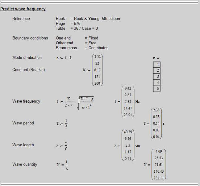

Here are some calculations to get you started.
Part 1 of 2.
Whenever I do such calculations, I first do a simplified estimate then hope it is close to observations. If so, then I proceed with a detailed analysis; otherwise I know my model is a poor representation so I step back and revise it.
Here I have simplistically modeled the plant stem as a cantilever beam with a fixed base and a free opposite end. I would not expect the beam's (stem) response to be sensitive to any anisotropy in the sectional properties since the structural stiffness is mostly derived from the outer ring of a cylinder (note: you can compare Ig for a solid cylinder versus a hollow cylinder and notice the lack of sensitivity).
You need to measure the weight density of the beam as it is relevant. (Just weigh a very long length to factor out any local irregularities.) In the meantime I have guestimated it at 45 p/ft^3 which is probably characteristic of moist woody material (note dry wood is 35 pcf whereas pure water is 65 pcf).
I don't know the boundary conditions of your experiment. You need to identify this as it influences the "response" of the beam. I have made some assumptions in my calculations which need to be scrutinized.
Is the stem uniform in diameter over the full length? You indicated this to be so in your write-up. However, if it is instead conical (say 6 mm and tapering to 4.5 mm, then this would have a significant effect on the beam's response). You need to be accurate here.
In designing buildings structurally for seismic loading (isn't this a bit similar to your experiment?) we develop a finite element model. The model accurately determines the stiffness and response characteristics of our building tower as driven by a synthesized seismic spectrum (your forcing function). The model will determine the "participation" that each mode of vibration has upon the building. In your case, I haven't yet done this; instead, I have simplistically estimated the first 5 modes of vibration. Matching the "wave quantity" with what you observed (how many standing waves) would reveal the actual mode of vibration that has the highest participation (dominance).
Anyway, this should start you off.
Part 2 of 2.

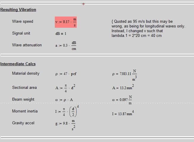

Using your constants I got the following wave lengths:
  • K = 3.52 Hz --> λ = 1583.3 m
  • K = 22 Hz --> λ = 271.43 m
  • K = 61.7 Hz --> λ = 96.94 m
  • K = 121 Hz --> λ = 49.22 m
  • K = 200 Hz --> λ = 29.69 m
The actual wavelength I observed is 20 cm, so this is way off. I suspect the wave speed is incorrect - 95 m/s (not cm as I wrote before, sorry) is one of the two numbers I got elsewhere and describes the wave speed of 200 Hz vibration in a woody branch. Would detecting the vibration at the source and some distance away, and then comparing the signal onset timing be good enough to really determine this? We use laser vibrometers for detection. Still, my result is two size categories larger, so if you'd be so kind, please re-check my calculations. Second number I got from another system is Young's modulus. How would I measure that?

Please review my original attachments; I have made corrections and incorporated your revisions. Additionally, I changed the wave velocity such that the first mode of vibration matches your observed wave length of 40 cm.
Be careful here. A wave length has one trough and one valley (up and down) cycle. This is the wavelength for which a visual standing crest or trough of 20 cm would have a wavelength of 40 cm (mathsheet reads 40.4 cm). You should confirm my understanding of your 20 cm.
If this model is correct, then you would have observed a period of vibration of 2.4 sec - very easy to notice. What frequency did you get?
I ran another trial in pursuit of matching your results and calibrating it with expected behaviour of a cantilever.
In principle, the 1st mode of vibration of a cantilever beam has a wavelength that is 4 times the length of the cantilever. So I changed v until N=0.25. Then I looked at lambda vector to find the element that has a wavelength closest to your observed half-wavelength of 20 cm (full wavelength = 40cm). The 3rd mode of vibration reads lambda.3=36 cm. The corresponding period is 0.14 sec; that is 6 cycles a second or 1 half-cycle in 1/3 second - oh! you should be able to notice this with your eye.
All the modes are characteristic of the beam itself and its boundary conditions; the forcing function does not influence the mode vector. So, if you removed the device that previously applied the forcing function, then the beam would have boundary conditions true of a cantilever. Now you could merely tap the free end with your finger hand notice the 1st mode of vibration. The period of vibration that you measure here can be used to calibrate the mathsheet with the true wave speed.
If this revised model is correct, then you can ask why does the insect choose to over-exert itself to force the stem into a higher mode of vibration. Note, higher modes always require more energy. Well, you could rationalize that the lower modes, such as mode 1 with a period of 2.38 sec is so slow that the wind could easily achieve this and thus provide unintentional "communication signals". So, the insect deliberately is willing to exert extra energy so as to push the stem into a higher mode that would not occur during common wind conditions. This begs for another experiment: see if the insect is unaffected by lower frequency vibrations. You could easily test for what frequencies of vibration the insect is responsive to. This would then correspond to certain range of plant stems (diameter and length combinations) that they would be able to communicate on.

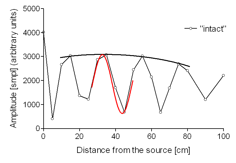

Right, let's get to the bottom of this. First, I owe some details to clarify what's happening. Some of those I deliberately withheld to not influence the calculation, but that might not have been such a good idea, because I'm beginning to get a feeling that we're not talking about the same thing.
Me and the insects induce 100 Hz vibrations in the form of pulses about a second long. Below is a graph of amplitude change in those signals with distance, expressed as maximum velocity of particle movement (= 2πf × max. displacement) at each point.
You will see that wavelength of the pattern is indeed 20 cm, but the fundamental frequency of underlying pulses (not shown here) does not change significantly and is always approx. 100 Hz. What does change is the appearance of harmonics at 200 and 300 Hz. Another interesting thing is, that wavelength of the pattern and even position of the peaks don't change if I shorten the stem. Other two lines represent the experiments where I cut the upper 10 and 20 cm of the stem and stimulated 1 cm below that.
The sketch of the stem you provided in your first post is correct. When the insect sings, it can obviously stand on any point, we don't know if they pick the position according to what their vibrating causes in the stem.

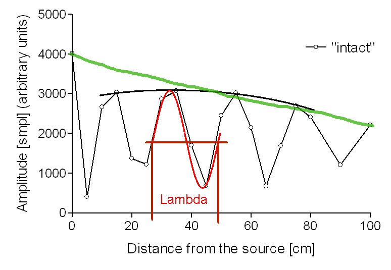

Your graph shows nodes spaced at 20 cm. Thus the wavelength is 40 cm. If you are uncclear then just sketch a sin wave transcribed thru both the positive and negative swings.
I think I can even see the 1st harmonic. This is prescribed indirectly by the interconnecting all the local maximums, despite this being a graph of velocities.

You mean like this?
This is getting more interesting by the minute. Although I still can't see the 40 cm wavelength - it's closer to 30 than 20, but still... Please correct me if I got it wrong.
I'm afraid the stem is too weak to stand upright by itself when the plant is this tall, but I'll try oscillating a shorter one. As for the insect, it weighs around 130 milligrams, which is pretty much negligible compared to stem weight.
Yes. For clarification, you can realize that the ends of a oscillating cantilever with sway will have a higher peak velocity then diminishing as you move closer to the fixed base. My green line is a better regression and consistent with theory.
I agree the wavelength (Lambda) is closer between 25 and 30 cm, not 40.

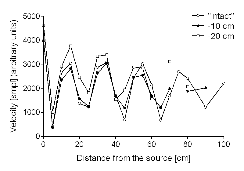

I'm not sure about your regression line. I left out point zero deliberately, because it's recorded directly opposite of the shaker, which is fixed and cannot oscillate freely, so it more or less registers its movement.
I'm resurrecting this thread because I am still not any closer to the solution, so please bear with me.
I tried what Skeleton proposed and determined the first harmonic. On a 83 cm tall stem, the period is almost exactly 1 second (around 980 ms, to be precise). But putting this value in the equation given above is problematic, because I don't know the speed of propagation. Waves in plants are dispersive, meaning that different frequencies have different velocities of propagation. Any ideas?

I'm familiar with the work of Cocroft's group, thanks. Their system is a bit different, though, because the little buggers they study communicate using higher frequencies that don't transmit as effectively as low frequencies that our buggers use. Plus, they're smaller.
The thing you said about simultaneous waves made me think, though. If I measured at two points within the same observed wavelength, I should get peaks of particle movement exactly at the same time. If the phenomenon observed isn't a standing wave, the peak would be positioned accordingly to how fast the vibration propagates. Is this a correct reasoning and is demonstrating this a good enough proof for the existence of standing waves?
We argue on other (neurophysiological) grounds that the very beginning of the signal (where the rebound signal doesn't arrive yet) is important for localization, the rest of the pulse only serving as a species-specific signal, so the lack of directional information might not be as problematic.

If you have a taut rope tied between two distant trees or posts, and give it a quick hit in the middle with a stick, you will see traveling waves (moving distortions) moving toward the trees, and reflected waves coming back. the forward and reflected waves pass each other without interference. Insects and spiders can determine the arrival times of the waves if there is no reflection or if they do not overlap. If the waves completely overlap, they are called standing waves (equal amplitude simultaneous waves in both directions), and the amplitude depends only on the location between the two posts.

Looks like I didn't explain what I meant clearly enough.
Let's try again: I have half a second long pulse with 100 Hz frequency, traveling at velocity of approx. 75 m/s along the plant stem. If I induce vibration at the top and detect vibrations 50 cm above the ground (somewhere below the top), it means the wave has to travel half a metre down, bounce back, and make the same distance back, which takes it 13 ms. At 100 Hz frequency, it means that more than one full cycle of particle movement on the forward wave goes on without interference. This cycle does contain directional information. Only the rest of the pulse is relevant for determining whether standing waves occur, which I thought to do like I explained above.
I think you are not choosing the right dispersion relation. As far as I see, you are choosing BULK flexural waves (full volume bending), when the statement of the problem speaks of surface waves, which are exponentialy decreasing with depth
Try rayleigh waves instead
