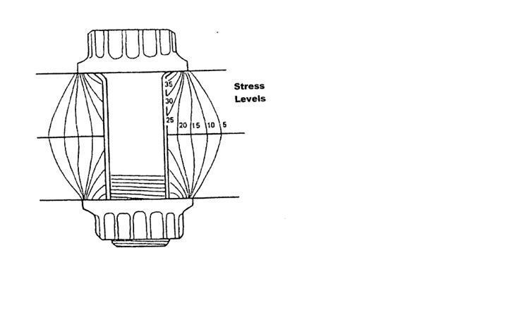

Thanks..got it and thanks for the link. So here are a couple of situations...let me know if I'm thinking in the right direction. And please pardon the inaccurate drawings, I did it on an excel spreadsheet.
Figure 1 is where the core/nut exert stress equally in both directions and meet in the middle as shown by the red lines. Now, if I had end plates that had a higher tensile strength (and sorry if that is not the proper term) than the nut/core system, could I get the distribution of stress as shown in figure 2.
And could you say it is likely that a system could actually have a mixture of the two figures? (as in, are forces always 45 degrees? and don't meet in the stack middle)
Now what might happen if I add a bunch of washers to one end as in figure 3? I have shown it with unequal distribution (and therefore I change the 45 degree angle.) Does one side show increased stiffness?
And lastly, say I insert an infinitely stiff (for the purposes of discussion) plate in the center as in Figs. 4 and 5. Do I get a distribution more like figure 4 or 5...or do the stack ends adjacent to the core/nut ends show the 45-degree distribution, and the stack center fans the entire cross section (like Fig 2).

Hi Kathie,
It’s nice to see someone respond to their own posts with so much dedication so thanks for that. Let’s see if any of this helps . . .
kathie747 said:
Well more or less, just speculating on what's cause and what's effect. To get a little more specific, this is a fuel cell and during certain parts of cycling we have H2 and O2 recombining. With proper gas channelling, that meeting is friendly, but if we have gas pockets, that meeting can be less than friendly.
Ok, so maybe if the stack isn’t compressed, you get bigger gas pockets and that’s allowing larger quantities of H2 and O2 to pool up before combining? If that’s the case, then perhaps you’re thinking that if you can eliminate or minimize these pockets, there won’t be large buildups of H2 & O2. Hence the interest in a uniform compressive load?
How large are these poockets?
The picture I’d posted a link to previously just shows a generic bolt and a generic compression distribution under the head. Really isn’t the best picture. Attached is another picture taken from a textbook I have. Here you can see the lines of constant compressive stress for a ‘typical’ bolted joint. It looks similar to the previous one but you can see the lines aren’t 45 degrees. Also note that directly beneath the bolt head is where the compressive stress is highest. This stress distribution will vary depending on the modulus of elasticity of the material (not tensile strength) and also depend on overall geometry.
In your case, the plates between the two bolt heads are probably not very ‘stiff’ (ie: they probably have a relatively low modulus of elasticity) so the stress distribution would look different because the material is different. However, the general distribution would be similar.
The only reason adding ‘washers’ (preferably a single ‘washer’ of the same thickness) would make any difference at all is because this would make the bolt head stiffer, but a typical bolt head is about as stiff as you’ll get so adding anything of the same diameter isn’t likely to change anything.
If your intent is to produce a uniform compression throughout the stack as shown in your figure 2, I can think of 2 ways that might be accomplished. The first way is as skeleton mentions. Have you ever seen an 18 wheeler pulling a flatbed trailer going down the highway, but the flatbed trailer is bowed up in the middle and there’s no load on it? The beams that make the trailer are actually made bent like that – they’re bent slightly so that when the trailer is fully loaded, they straighten out.
Now imagine a circular plate that’s made to do the same thing - flatten out when a load is produced in the center. It would look a bit like a contact lens. If you took 2 of these slightly bent circular plates and placed one on each end, such a plate could theoretically produce a uniform load over your entire stack of plates as you show in figure 2. However, to design such a plate would require a large team of coops, an expensive FEA program, a few dozen pizzas and a large box full of cash.
