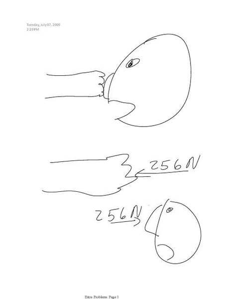

DaleSpam, how are those forces "equal"?
Again, you are mistaking the effect of a force on a particular body with the fact that the forces exerted are equal. The same force acting on different objects can easily have different effects.
In your wonderfully morbid spear-eye example, the forces felt by both objects are equal, but an eye cannot handle as much force as the metal tip of a spear can, so it breaks.
Alright, Object X is thrown at material Y. If material Y experiences Z amount of force it will shatter. So if object X is chucked with a force GREATER THAN Z when it comes in contact with a material Y, X will exert a force Z (since it is all Y can muster) on Y (the result of this on Y will be that it shatters), Y will also exert an equal and opposite force Z on X (which, if the total collision/shattering took t seconds then this will result in object X loosing Z*t momentum), this may also dent X or what have you. However, if the force with which is much greater than Z it will still have a non zero momentum after its shattering collision with Y and will keep on going. It's like static friction, the force of static friction equals [itex]f_s \leq \mu_s N[/itex]. Notice the less than equal to.
