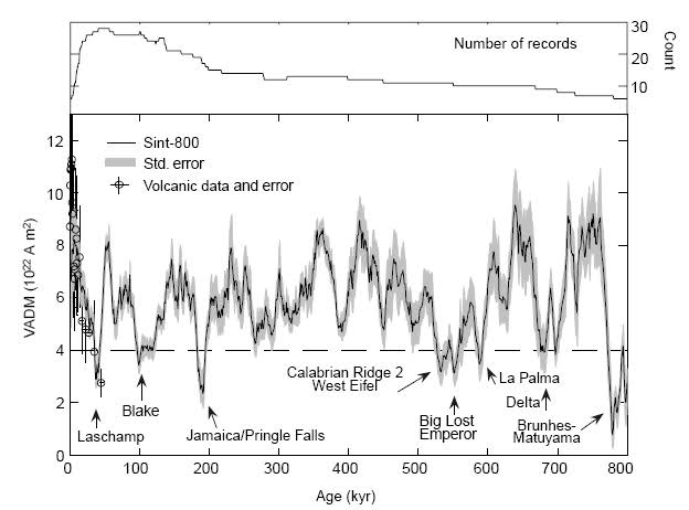

Anyway, the Laschamps event was big, but so was Blake and many other paleomagnetic excursions. Lachamps was not unique.
source Guyodo and Valet 1999
However Paleomagnetic excursions were just as common in the later part of the previous Matuyama chron http://www.agu.org/pubs/crossref/2002/2001JB000491.shtml
Magnetic excursions (defined here by virtual geomagnetic polar latitudes crossing the virtual geomagnetic equator) are observed at 932, 1048, 1115, 1190–1215 (Cobb Mountain Subchron), 1255, 1472–1480, 1567–1575 (Gilsa Subchron), and 1977 ka.
See that there is nothing unusual at 40 ka
Notice that a semi ~100,000 years cycle seems to be kicking in 1.1 Ma which is also sort of visible in the Guyodo graph for the Brunhes chron. It's not synchronous with the Maritieme isotope stages, but could there be a connection anyhow? Provided that this also also started about one million year ago.

The Earth's magnetic field suddenly dropped to 10% of it's current strength! This is absolutey amazing. Just because geomagnetic excursions have happened a few other times in the last 800,000 years doesn't detract from it's significance! It should also be noted that this an area which is still very poorly understood and that there may be a number of reasons for the Earth's geomagnetic excursions and reversals.
Mammo said:
The Earth's magnetic field suddenly dropped to 10% ls.
that's the idea of ALL the Paleo Magnet Excursions. There is nothing significantly different with the Laschamps event, compared to the others.
Can you not concede that the sudden drop to 10% of the Earth's magnetic field around 40,000 B.P is an indication of a major event? It is the fact that it so recent in our history which makes it so significant!

But it is not unique. Happened 14 times more to the 10-20% range. Perhaps click a link sometimes and study.
again: http://www.geo.uu.nl/~forth/publications/Related_pubs/Gubbins99.pdf
It doesn't allow copy paste so you really have to actually open it.

There is something unique about this excursion. Please look at the graph in the http://209.85.229.132/search?q=cach...storf+(2003).+timing&hl=en&ct=clnk&cd=5&gl=uk (click on html at the top for the graph version). It clearly shows that at around 41ka there was also a period of rapid global warming, similar to a D-O event, but out of phase with the 1,470 year cycle. This is first class evidence, which the author appears to have missed.
It also suggests that the mechanism of the 41ka excursion could be closely linked to the mechanism of the 1,470 year cycle.
