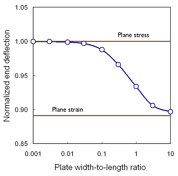

Prompted by your question, I decided to simulate beam/plate deflection by FEA and compare it to the analytical solutions,
[tex]\delta=\frac{4PL^3}{Ewt^3}[/tex]
for cantilevered beams subject to a transverse end load and
[tex]\delta=\frac{4(1-\nu^2)PL^3}{Ewt^3}[/tex]
for cantilevered plates, as derived in my link.
As shown in the attached image, the end deflection smoothly transitions from the plane stress to the plane strain solution as the beam width increases (that is, as the beam transitions into a plate). The thickness was 1% of the length for all simulations.
The results support the rule of thumb that the beam solution is accurate when beam width is at least an order of magnitude less than beam length.

I can see here that the stiffness really depends on the width to length ratio, and the factors derived analytically are only approximations. The diagram is illuminating.
