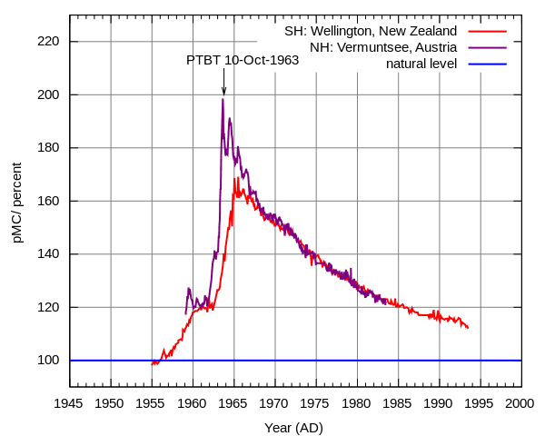

I found the below graph at wikipedia:
Now I need to figure how to convert pMC/percent to a moles % or anything I can comprehend.
The problem is that graph is scaled to the natural level, so you'd have to know the natural level of C14 in the atmosphere (the excess was caused by nuclear testing).
C14 is (according to wiki) about 1 ppt of C12, or 600billion atoms/mole of carbon.
The accurate ratio is hard to find because most standards work in terms of decay rate rather than proportion.
