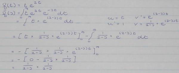

The question:
Find the Laplace transform of f(t)=[tex]te^2^t[/tex]
I have got:
Though, this will not become f(s) = 1/(s+2)^2
Anyone got an idea about what I am doing wrong?
That's good because it's not supposed to become that! The answer is:
[tex]\mathcal{L}\left[te^{2t}\right]=\frac{1}{(s-2)^2}[/tex]
This is exactly what you have.
