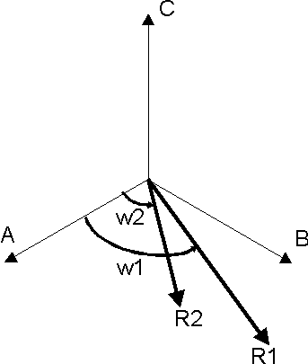

Thanks for the help, I have a follow up question:-
Does the following still apply?
(V1)(U1)+(V2)(U2)+(V3)(U3) = (R1)(R2)cos [(w1-w2)]
where V and U are the input vectors referenced to the 2D 120degree separated 3-axis co-ordinate system. R1 is the magnitude of vector V and R2 is the magnitude of vector U. w1 is the angle of R1, w2 is the angle of R2.

The phase comparator in a three phase phase-locked-loop. i.e. I've calculated the dot product of the incoming mains samples with the feedback waveform samples without doing a Clark tranform to the incoming mains samples first. The aim is to reduce computation time and keep all information, the downside is now the waveforms are not orthogonal, and hence my doubt whether the relationship between the dot product and the UVcos(u,v) holds.
The code is running in a TI DSP, but I have been getting errors I cannot account for when the incoming mains is unbalanced. Its either a calculation error or an error in the fundamental mathematics, hence the questions regarding the relationship between the dot product calculation and the commonly used polar form. I'm attempting to narrow down the options.
The overall application is a 3 phase rectifier.

Ah, now I see why you didn't want to use an orthogonal basis. So, I hope that my expression for the dot product in a non orthogonal basis was clear.
to clarify would the answer for 120 degrees between unit vectors be:-
u.v = (u1)(v1)+(u2)(v2)+(u3)(v3)-(0.5)[(u1)(v2)+(u1)(v3)+(u2)(v1)+(u2)(v3)+(u3)(v1)+(u3)(v2)]
then can I assume that this is equal to:-
(u)(v)cos(angle between them)
I need the polar form to be representive as I feed what is now the scaled cosine of the phase error into the NCO to generate the feedback waveforms

It looks right to me to me provided that by unit vectors you mean the basis vectors for your coordinate system. It sounds like from your above post that you are doing a power application. It would make sense that if each waveform was a sine wave then the phase should be related to the angle between the waveforms.
However, if the waveforms were something else, then this wouldn't be the case.For instance, if the waveform was a pulse train then a small phase delay would cause the waveforms to be orthogonal.
The inputs (U) are sinewaves as are the feedback waveforms (V). when locked the feedback waves should lag the input waves by 90 degrees.
the three axis are 120 degrees apart. I was calling these the basis vectors.
let me know if I'm deluded :-) Thanks

By axis I presume you mean the inputs waveforms. You actually only have two linearly independent basis vectors since any sine wave can be represented as the sum of a sine wave and a cosine wave.
That said you can still represent the wave using an over determined set of basis vectors if you wish. My guess is somehow you know how to represent the feedback waveform in terms of a sum of the input vectors.
