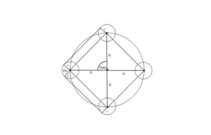

I'm trying to find out the length of a loop which is enclosing 'n' number of cylinders.
I've found the length of the loop touching the cylinders, and now need to find the rest of the length of the loop (which is not touching the cylinders).
The formula I obtained for the length of the loop touching the cylinders is as follows;
L (of loop touching cylinders) = 4[2pi(r)(3pi/n)]
given that a pentagon has an internal angle some of 540 degrees.
I need clarification that this part of the formula is correct and need the remainder of the formula which I've stated above.

Here is a top view of the diagram I've drawn, indicating the sections I've found the formula for:
http://i44.tinypic.com/mk95sn.jpg

Alright guys, I've finalised my complete formula.
I found it to be;
L (total) = 3(2πr + Rcosπ)/n
Did anyone else get this formula, can I please get a confirmation?

That's not what I get. The part that depends on 'r' is the part touching the cylinders. I get that that is just 2*pi*r. How do you get that it's multiplied by 3/n?
