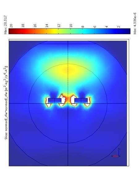

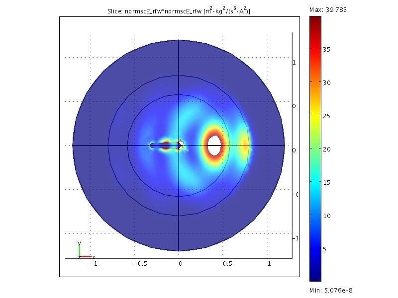

Hi, to make it a little bit clearer:
I have a problem with reflection of scattered field from PML (I guess). I remove scatterer, and just solve problem with geometry I want to use. There is always some kind of interference pattern of scattered field. I can decrease the reflection intensity by making PML thicker (better solution), or moving it further away (not so efficient), or both. But it´s wasting my memory. Patern depends on direction of excitation as well as on wavelength.
My geometry is spherical encapsulated in spherical PML. Pattern is different depending on what parameters i set (cartesian or spherical), although the natural choice must be spherical. Also I define scattering boundary conditions on outer boundaries.
Metallic scatterer is inside. It looks like reflections are independent of presence of scatterer. I know that solving is not selfconsistent procedure, but anyway it looks weird that it´s independent.
Any tips?
ps. I know there must be always some reflection, but in my case is comparable to the strength of field scattered by object of interest

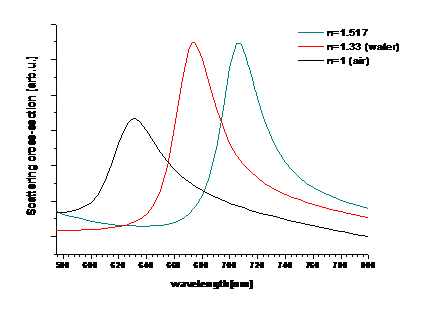

i think maybe relocate the PML further from the particle helps. the evanescent tail of the surface plasmon should be avoid from extending into the PML.

This is how it looks.
Cylindar made of gold, 50nm diameter, 10nm height, laying on glass substrate...
Integration sphere for Straton-Chu was placed on 175nm from the center... That is the one geometry that worked fine in my case...Spectra are in case of air, water and dielectric of 1.517 ref. index...

Did you compared it to any experimental data?
thx
Not particles of that size, but they behave in expected way. For instance Bulk refractive index sensitivity is more-less expected. I did long time ago for the bigger cylinders that I fabricate, and it fitted well.
I can try again.
Anyway, it looks like one have to optimize PML and meshing to get geometry that will behave fine. I was lucky with this one...

IMPORTANT Update regarding this post:
It looks like COMSOL has problems regarding PMLs performance for versions older than COMSOL 3.5a+patch.
I made geometry as always in scattering formulation (solving for scE), all air and PML, and have launched plane wave with amplitude 1 V/m. Scatered field instead of 0, was on the order of 10-40% of my excitation throughout the whole volume. That was solved in my COMSOL 3.5 version.
My friend solved my model in his 3.5a+patch, and he got scattered field on the order of 10 to power of -4. (4 orders of magnitude, without any optimization of PML, just default values)
So, if you have older versions forget about scattering formalism, you should solve it for total field...
I am about to get new version, and I will post how it behaves!
Regards
Last update:
If you don´t have COMSOL 3.5a with installed patch, just forget about solving for scatered field (scatered harmonic propagation in RF module)...
Just got Comsol 3.5a, and default PMLs work very good. No more weird reflections, near field looks very neat...
Cheers
