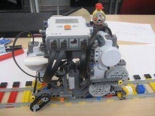

That's a great idea... but, yes, it has been done, by students at Aarhus University. They have a blog about it, at Lego of Doom, including a video of it in operation.
Cheers -- sylas
Yes, but they used a computer chip to store the transition table and compute the next state. I want mine to be entirely mechanical.
Cheers -- sylas
WoW I saw the video, so cool.

Hi,
In the end lego was too expensive so I used carboplast, popsicle sticks, plastic bottles, rubber bands and a glue gun. Here's the result:
The turing machine in the movie can run down the track and flip bits according to a program determined by the wiring. Currently it can only execute simple programs because it doesn't have external memory. But that's theoretically simple to add because I'd just have to build another identical unit that operates on one bit only for each bit of memory.
