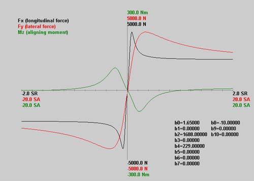

to shed some light on ABS...
ABS is a system that optimized the braking force in a car. It does this by maintaining the optimum slip ratio (usually around -.1, depending on surface and tires) during braking. when the slip ratio is at its optimum level, the car experiences the greatest force out of the tires, and thus the maximum braking force.
It does this by changing the pressure at the brake pads. Ideally, the upper controller would look at the velocity of the car, the speed of all the tires, and the car properties and determine the optimal brake pressure. then a brake pressure management system would achieve that.
But there isn't a device that can amnage the pressure in the brakes in such a way. So, in actuality, the upper level controller of an ABS system determines if the slip ratio is too high, ie. the brake pressure is too high. If so, then it sends a signal to the ABS system to lower brake pressure.
When the slip ratio is a little less optimal, the controller tells the ABS system to increase the brake pressure.
Increasing and decreasing he brake pressure is done by a fluid "circuit", with solenoids acting as switches to enable different paths for the fluid to travel thus lowering or raising pressure.
So in your saying that maintains static friction throughout the stopping process through millisecond releases is right in the millesecond releases (the solenoids increase or decrese pressure), but they don't exactly maintain static friction. This is more to do with the way a car's tire is modeled than ABS, but the tire forces you will get out of a tire depepnd on the tire's slip ratio, as i mentioned before, and the ABS system tries to maintain that at an optimal level.
Here is the relationship between tire slip ratio and tire forces for some tire. It is the black line.
notice how the tire force maxes out at around .1 (for accelerating) and -.1 (for braking). The ABS controller maintains the slip ratio in the area around -.1.
