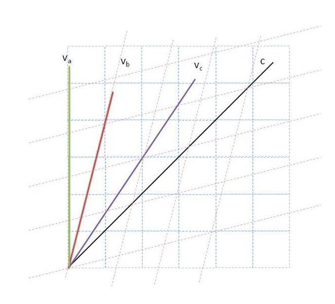

I'm a visual sort of guy, and there may be others out there, so I have attached a jpg of velocity addition for a slightly different scenario.
The image is taken from the perspective of A, for whom B is moving at 0.25c and C is moving at 0.666c.
Look at the red dashed lines, these are B's equivalents to A's blue dashed lines.
Using those you can see that for B, C is moving at 0.5c and A is moving at (minus) 0.25c.

O Great One said:
Yes. That is what I was assuming. So, does that mean that the velocity of C relative to B is such that when you apply the velocity addition formula you get a velocity of C relative to A of .5c?
Of course!
You can use the velocity addition formula to figure out the speed of C relative to B. (It turns out to be c/3, not .3c.)
To stretch it a bit further, the generalized velocity addition is neither commutative nor associative (see for instance Ungar).
