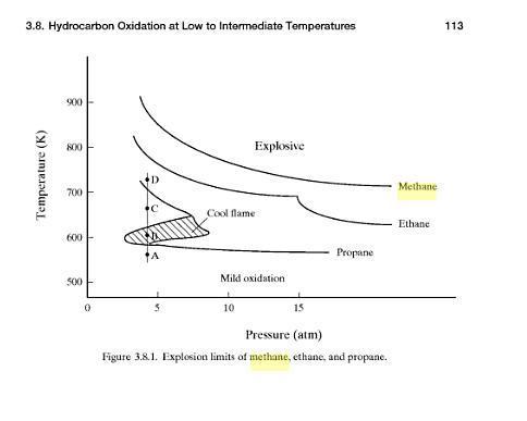

I want to figure out what pressure would need to be applied onto a 5% methane 95% air mixture to heat it up to the autoignition temp of 853 K.

The problem is I am going to have to pipes coming into a T. Compressed in one and methane in the other. My intention is to only have one of them on at a time, but I wanted to make sure in case a valve failed etc, that if the two flows met at pressure, they wouldn't autoignite.

At first I thought you asked about adiabatic compression where temperature rises till it is high enough for autoignition (853 K) - something like is happening in Diesel engine.
But now you state you will be mixing compressed gases. You can compress them, cool them, mix them. No heating, no autoignition.
Or am I missing something?
That is true. I just needed to numerically prove what temperature pressure relations auto ignition could happen at even though our temps would be no where close. they wanted to see it on paper, but I found what i needed in a combustion physics book but thank you so much for the input!
Here is more or less what I was looking for(attachment):
