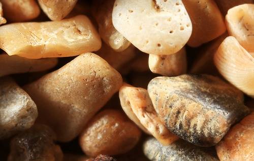

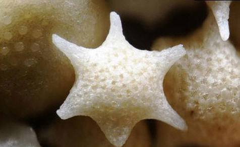

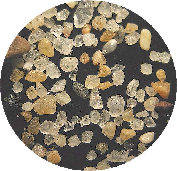

You've got me wondering what sort or shapes the grains should be to best perform filtering. Both high porosity and places for debrit to cling or bond would seem to be important. Which would be best; sharp edged sand, or rounded? I think that diatoms would be very sharp. Or maybe it makes little difference.
A magnifying glass could answer what kind you are using. There should be magnified pictures of sand on the net.
...So I pulled up a few.
http://www.icbm.de/pmbio/mikrobiologischer-garten/pics/for02.jpg
Beautiful in magnification.
I read just yesterday that, after ten years or so, "the edges have been worn off" the sand, so it should be replaced.
I also found out that sand and diatomaceous Earth are not interchangeable in a filter.
