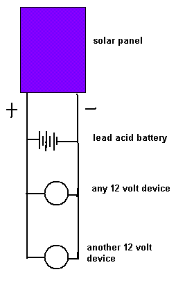

I estimate it will cost somewhere between $1000 and $3000 for what you want. But there are many variables we do not know, so it is difficult to say for sure.
ps. PV panels are not anywhere near as complicated as rocket science.
