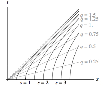

But what kind of accelerating frame do you want to use for the rockets? The normal type of coordinate system used for objects undergoing constant coordinate acceleration is Rindler coordinates, which have the nice property that at any given point on the accelerating observer's worldline, Rindler coordinates will define simultaneity and distances to other objects at that moment in the same way as they'd be defined in the observer's instantaneous inertial rest frame at that moment. And in Rindler coordinates, only a family of observers undergoing Born rigid acceleration would remain at rest--Born rigid just meaning that the distance between them stays constant in each observer's instantaneous inertial rest frame from one moment to the next (in this case a taut string between the ships would not break). But in order for this to be true, it works out that different ships must undergo different constant proper accelerations, so from the perspective of the inertial frame S they'd be accelerating at different rates. This page on the Rindler horizon has a diagram of what the paths of ships at rest in Rindler coordinates look like from the perspective of an inertial frame, along with a little explanation:
We can imagine a flotilla of spaceships, each remaining at a fixed value of s by accelerating at 1/s. In principle, these ships could be physically connected together by ladders, allowing passengers to move between them. Although each ship would have a different proper acceleration, the spacing between them would remain constant as far as each of them was concerned ... When an object is accelerated in such a way as to preserve the proper distances between its different parts, this is referred to as Born rigid motion (after the physicist Max Born).
So, if the ships are instead both undergoing the same coordinate acceleration as seen in the inertial frame S, that means that in either ship's Rindler frame S', the other ship is not maintaining a constant coordinate distance but is instead moving away, which is why the string breaks. If you want to use a different type of accelerating coordinate system than Rindler coordinates you're free to do so, but in a non-Rindler coordinate system it would no longer be true that a constant coordinate distance would mean a constant distance in the ship's instantaneous inertial rest frame from one moment to the next.
