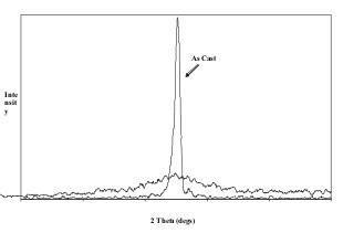

I am doing some research about nano porous materials. The bulk materials, I can get a X-ray peak for each element. But when I made it into nano porous material, the peak is gone. The same thing happened to my teammates. In one word, we can't get X ray for a nano-porous material.

It X-ray diffraction.

The width of your peak is a function of several things, including grain size, and residual stress/strain (sample prep, thermal strain...). Are your raw materials nano-structured? Or are you using a insitu grain-refinement technique? If your are losing your peaks due to grain refinement try scanning the angle where you know the peaks should be, but very slowly to try and increase the number of counts, sometimes this will make it easier to distinguish a very low height, high width peak, from the background. I just worked on this today, so I'll attach a figure displaying what I mean.
I hope this helps.

Thanks a lot. I see what you are talking. I will try a small and slow scan.
