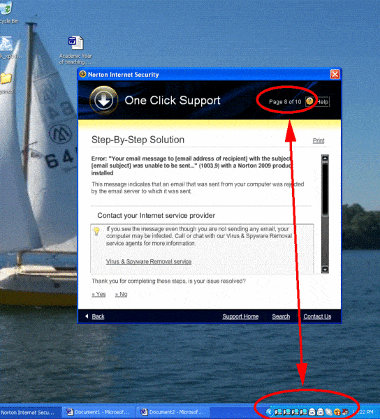

It looks like my desktop was infected with a virus due to a fault in Norton* that caused it to not update its virus definitions.
The virus turned the system into a zombie, sending out spam. Now many ISPs are identifying my IP as a source of spam and are refusing all email from me.
Norton found and purged a virus called backdoor.formador, so I think all that is behind me now, but I still have 4000+ emails that are trying to get sent from somewhere. (Norton continues to pop up a warning message for every one of these 4000+ emails, that's how I know they're still there).
See attached screengrab. The taskbar is showing each email that is waiting to be processed. So far there are only 8 or 10, but it will run through 4000+ of them.
They are not in Outlook; I don't know where these 4000 emails are sitting. Somewhere invisible. How can I purge these emails?
Or am I misunderstanding what I'm seeing?

Dave,
What OS are you using (XP, 2000, ...)? I did a quick Google search and one thing that I noticed from the technical details on one was that the computer could be reinfected if you don't disable the System Restore feature before removal http://www.symantec.com/security_response/writeup.jsp?docid=2003-121018-1953-99&tabid=3".
I would also double-check that the registry entry noted in the removal instructions has actually been removed.
HKEY_LOCAL_MACHINE\Software\Microsoft\Windows\CurrentVersion\Run\"[TROJAN FILE NAME]" = "%System%\[TROJAN FILE NAME].exe"
Also, if you don't have a firewall on your computer, you should install one.
