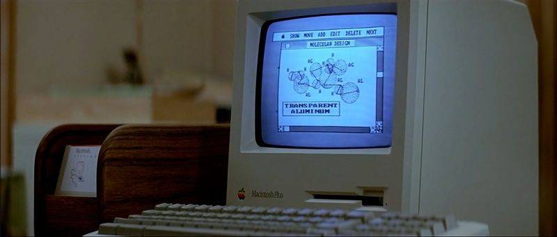

you mean this one
http://www.scifitv.com.au/Content/Blog/Pictures/Transparent_Aluminum2.jpg
That was a good star trek movie :) much better than the latest one
