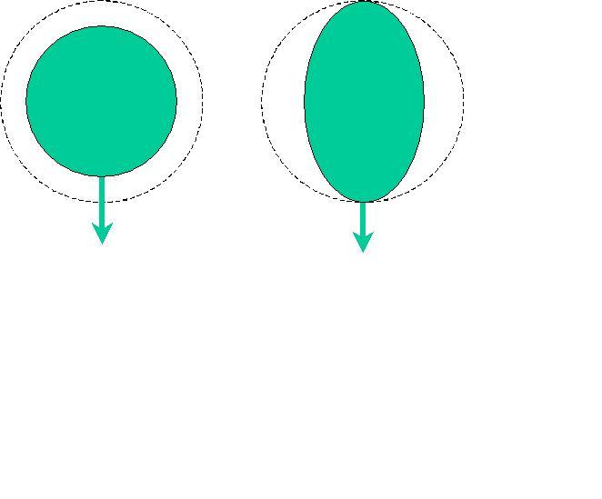

A drug delivery infusion pump is made out of thick synthetic rubber and has a very small outlet. The balloon pump is filled with 500mL liquid drug and is now inflated into a ball shape. The drug will exit from the very small outlet at a nearly (but not always) constant flow rate of 5mL/hr (takes 100hr to deplete).
How can I derive the flow rate as a function of time?
I'd also like to know how the temperature and drug viscosity affect the flow rate.
Someone suggested me to use Poiseuille-Hagen equation, but I need to know more details, especially how I can relate the flow rate to time and establish a model.
Your insight will be highly appreciated!

The "constant flow rate" is only indicative (by product manufacturer). The actual flow rate seems decreasing as balloon deflating (from experimental data).

sure we can simplify the model to start with, such as a perfect sphrical balloon shape, or even cylinder shape if that makes it easier, water as fluid, constant temperature, etc. I don't know what other information you need.
Yes sure, the post is "Need formula/help with mass air flow" at Physics > Classical Physics, it was similar but not the same because there we dealed with a fixed-volume air tank. However some eqs. may help.
The information I need is to modelize the balloon. Whether it decreases in volume as a sphere (or nearly does) or just wrinkle when water is released, or the description of the outlet in size, shape... are data that will allow us to make a good "practical" model of the pump.
Thanks a lot.
We can assume either
(1) the balloon remains as a sphere when the volume decreases, or
(2) the balloon keeps one diameter (along the axis of outlet) constant, while the radial dimension decreases.
whichever is easier.
The balloon is connected to a tubing, which has a very small outlet. The whole setup is more like the IV infusion bag, but instead of using a medication bag and the gravitation, we have an elastomeric balloon here.

Well, I see. The fact is that this is quite complicated because of the elastic nature of the balloon. Picking one of the options, it'd be far easier (1) rather than changing the very geometry of the balloon each second. I´m afraid I can't make a practical model of this if I consider it "realisticly" elastic.

It's not just a small hole (at least the devices I have seen)- there is a 'frit' inside that produces a constant resistance. The elastic energy of the balloon produces the driving force, pushing fluid through the porous frit.
The Hagen-Poiseuille equation will not readily apply, due to the presence of the resistive element. A better approach would be Darcy's law (Or Poiseuille's law with a resistive term, sometimes called the Brinkmann equation).

That's because the elastic energy of the balloon slowly dissipates as the balloon deflates- think of it as the driving force decreases over time.
