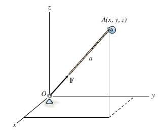

As shown, the cable OA exerts a force on point O of F = Fx(i) + Fy(j) + Fz(k).
If the cable's length is a, what are the x, y, and z coordinates of A in terms of a, Fx, Fy, Fz.
I am really not sure how to go about this. Please help!

Hint: you know that a is parallel to (Fx,Fy,Fz) :wink:
