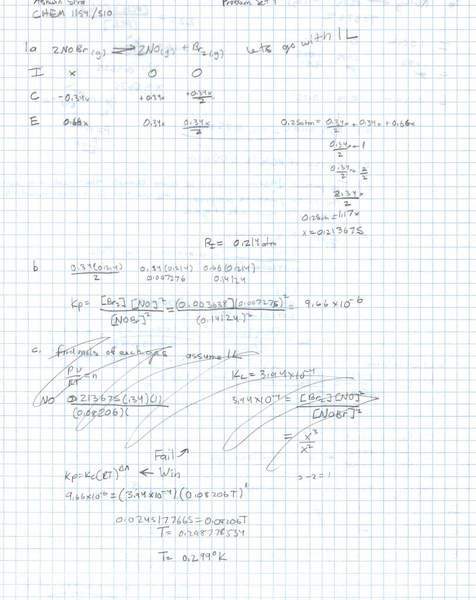

1. A flask initially contains only NOBr gas. Once heated to a temperature T, 34.0 % of the original gas decomposes via the following equation to give a total pressure of 0.25 atm at equilibrium:
2NOBr(g) [tex]\Leftrightarrow[/tex] 2NO(g) + Br2(g)
Given a KC of 3.94 x 10-4 I need to find the temperature. I've already gotten the KP and initial concentration as being 9.66x10-6 and 0.213675 atm respectively. I didn't see any equations for this in my notes...so how can one go about this business?

From other parts of the question, I calculated the initial pressure of NOBr, as well as the final equlibrium pressures of all the gasses, as well as the Kp.

The initial pressure of NOBr was .214 atm, the Kp I found was 9.66x10-6.
2NOBr(g) [tex]\leftrightarrow[/tex] 2NO(g) + Br2(g)
a) Determine the original pressure of NOBr in the flask.
b) What is the value of Kp at this temperature T?
c) If the value of Kc at this temperature T is 3.94 x 10-4, determine the temperature T.
That is the whole question.
That formula is on my formula sheet...ah well. So if [tex]\Delta[/tex]n is 1 then the answer is a decimal...
9.66x10-6 = 3.94x10-4(0.08206 T)1
T=.298778534 oK
Is that right?

So what went wrong? I see nothing else that failed. My calculations for the Kp and initial pressure look right.
Can you check my answers please?
Pressure looks OK, but Kp seems way too small to me.

I ended up with 9.65x10-6 again...
Show.
Kp = [Br2][NO]2 / [NOBr]2
Kp = (0.003638)(0.007275)2 / (0.14124)2
Kp = 9.66 x10-6
No, where did you get these values from.
methods
The preceding part using an ICE table and some math.
Hopefully this attachment can get approved soon...
It's part 1a.
Unfortunately it is 1 am here and tomorrow is Monday, so I have to go to sleep.
ICE table sounds OK, but values are wrong. From the data given in question [NO]/[NOBr] = 0.34/(1-0.34) - they should be comparable when it comes to value, you have them differ almost 100 times.
I don't get it...
Show your ICE table and how you calculated - for example - 0.007275.
I re-did it this morning with some hints from my Prof:
2NOBr [tex]\leftrightarrow[/tex] 2NO + Br2
I 2x / 0 / 0
C -2x(.34) / +2x(.34) / +.34x
E 2x(.66)/ +2x(.34) / .34x
The total pressure was .25 atm, so:
0.25 = PNOBr + PNO + PBr
0.25 = 2x(.66) + 2x(.34) + .34x
X = .02136752137
Then I just plugged it into the expression for each gasses concentration, and shoved those values into the Kp equation to get .1926125012.
That I plugged into Kp=Kc(RT)[tex]\Delta[/tex]n to get a temperature of 5957.399661oK... Is something wrong here?
