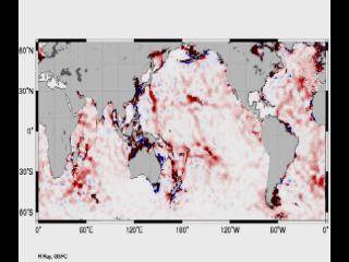

I meant that the heat track would be more visable in the dark. A big tide of ten meters should produce about 1/100 of a degree. A rattlesnake can resovle the difference.
It's not exactly a "track". There are attempts to identify where this energy is dissipated; but you can't do it by looking for tiny fractions of a degree over vast swathes of the ocean with much larger temperature differences already there for all kinds of reasons. Instead, you map the height of water and infer where the energy is being dissipated.
See this report for an interesting study on the matter: TOPEX/Poseidon: Revealing Hidden Tidal Energy, at NASA. The associated reference is
  • Egbert, G.D. and Ray, R.D. (2000) http://dx.doi.org/10.1038/35015531 , in Nature 405, 775-778 (15 June 2000), doi:10.1038/35015531
Here is a thumbnail image of the tidal energy dissipation zones inferred as part of this study; the NASA page has the higher resolution picture available.
Felicitations -- sylas
