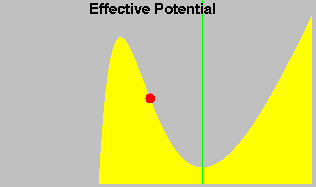

As I understand it, the energy barrier is not what prevents you escaping, but is what stops you falling in. The effective potential is unique to your angular momentum and if you have sufficient angular momentum then there is a barrier to falling in and although you might spiral inwards you simply spiral out again, but if you do not have sufficient angular momentum there is no barrier to falling in.
In the diagram above the red particle can not fall into the black hole to the left of it because it is prevented from doing so by the peak in the effective potential between it and the black hole. If the particle had insufficient angular momentum, then the peak would not be there because the effective potential is a function of its angular momentum.
