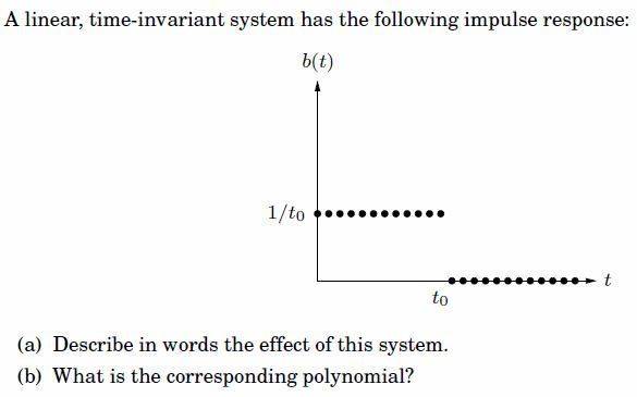

A linear time-invariant system has the following impulse response: (graph attached)
a. Describe in words the effect of this system
b. What is the corresponding polynomial
For part A I have "The effect of this system consists of an input of value 1/t0 which then has a “jerk” at t=0 and drops down to 0", however I'm not sure if that's what the book wants for an answer.
I understand the summation formula for multiplying polynomials, but I have no idea how I can generate such a formula from a graph.
The chapter spends half of a page talking about what an impulse graph does and how the formula is similar to the one for multiplying polynomials. The chapter is primarily on the fast Fourier transform, so this is probably somehow related.
thanks in advance!

A new idea popped into my head (I've been working on this for a few hours now), but again, I'm not sure if this makes sense:
= a(0)b(24-0) + a(1)b(24-1) + a(2)b(24-2) + a(3)b(24-3) + a(4)b(24-4) + a(5)b(24-5) + a(6)b(24-6) + a(7)b(24-7) + a(8)b(24-8) + a(9)b(24-9) + a(10)b(24-10) + a(11)b(24-11) + a(12)b(24-12) + a(13)b(24-13) + a(14)b(24-14) + a(15)b(24-15) + a(16)b(24-16) + a(17)b(24-17) + a(18)b(24-18) + a(19)b(24-19) + a(20)b(24-20) + a(21)b(24-21) + a(22)b(24-22) + a(23)b(24-23) + a(24)b(24-24)
For the simplicity of the following write-up we shall assign t0 = F
c0 = F/12 * 1/F = 1/12
c1 = F/12 * 1/F + 2F/12 * 1/F = 3/12 x
c2 = F/12 * 1/F + 2F/12 * 1/F + 3F/12 * 1/F = 6/12 x^2
c3 = F/12 * 1/F + 2F/12 * 1/F + 3F/12 * 1/F + 4F/12*1/F = 10/12 x^3
c4 = F/12 * 1/F + 2F/12 * 1/F + 3F/12 * 1/F + 4F/12*1/F + 5F/12*1/F = 15/12 x^4
c5 = F/12 * 1/F + 2F/12 * 1/F + 3F/12 * 1/F + 4F/12*1/F + 5F/12*1/F + 6F/12= 21/12 x^5
c6 = 28/12 x^6
c7 = 36/12 x^7
c8 = 45/12 x^8
c9 = 55/12 x^9
c10 = 66/12 x^10
c11 = 88/12 x^11
c12 = 0
c13 = 0
c23 = 0
