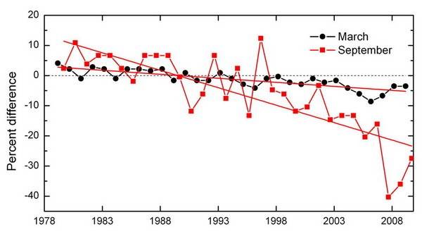

Figure S2. Time series of the percent difference in ice extent in March (the month of ice extent maximum) and September (the month of ice extent minimum) relative to the mean values for the period 1979–2000. Based on a least squares linear regression for the period 1979-2009, the rate of decrease for the March and September ice extents is –2.5% and –8.9% per decade, respectively.
-- Sea Ice Cover, update for 2009 to Arctic Report Card, NOAA, October 19, 2009 (http://www.arctic.noaa.gov/reportcard/seaice.html )​
Note that the difference between March and September trends means that the anomaly is tending to increase in September, and then recover again towards March; a feature Xnn and I have remarked upon in the thread.
