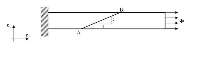

A round beam (radius R) is harnessed on the left side to a wall.
The beam is made up of two parts glued together by a thin layer of glue - the attachment plane is described in the picture as AB.
A 'glue fail' happens when the SIZE of the shear strain on plane AB is bigger the Sigma0 (some unkown value).
On the right side of the beam there's an equaly spred strain q=q0*e3 (note that q0 might be negetive as well).
What is the allowed value range of q0 so that there won't be a glue failure? (express your answer by using R and Sigma0)
this question was given as a challenge, and is a part of a course called solid mechanics 2 that deals more with shear strain and strain matrices. I really don't even have a clue of how to begin, i can't see how the radius R plays a part in the answer..
help, please?

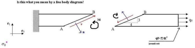

Hi dislect, welcome to PF. Do you know the relationship between force, area, and stress, and can you draw a free-body diagram and write the static equilibrium equations? These would go a long way in helping you solve the problem.
The translation looks pretty good, but "strain" should probably be "load" (or "force"), "distributed load," or "stress." Is is possible to find out which, since they imply different loading configurations?

OK, great. Now using the tangential force on AB, calculate the shear stress at the joint and compare this to [itex]\sigma_0[/itex] ([itex]\sigma[/itex] is almost universally used to denote stress, not strain).

In the problem, you're pulling or pushing on a beam with circular cross section. There's an angled, glued joint within the beam that can only sustain a certain amount of shear stress. Your job is to calculate how hard you can pull or push on the beam without making the joint fail. So you need to connect the axial load [itex]q_0[/itex] to the rupture shear stress [itex]\sigma_0[/itex]. Does this help?

I think you need to find the relationship between V and q0. I'm not sure where sin(30) comes in. A couple hints I can give are that (1) V is smaller in magnitude than q0 (assuming q0 is the axial force applied to the beam end) and that (2) V equals q0 when the cut is horizontal but is zero when the cut is vertical. Does this help figure out the trigonometry part?

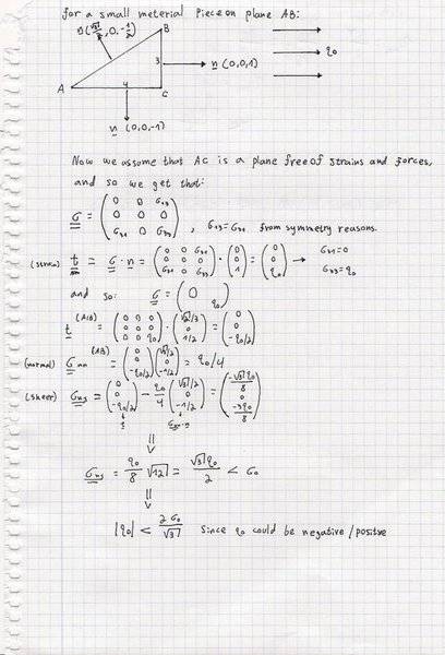

btw, just today we realized that q0 is an already spread force, meaning we don't have to divide it by A and the same goes for the V(sheer)!
Ok, so as I said q0 is an already spread force and therefor -< the strain ( no need to divide by A).
This is what we did:
* Is our assumption correct about AC? if so, how can we justify it?
* Is our solution correct? :-)
Thanks Mapes!
Right away, let me reiterate that a 3-4-5 right triangle does not contain any 30° angles.
It looks like you're getting closer.
EDIT: Try solving it for an arbitrary angle [itex]\theta[/itex]. Think about how the answer must change as the angle approaches 0° or 90°.

Sorry for spamming but I just got it.. its 53.1 degrees!
now given that i corrected the degree, is the solution ok?
(my other questions are still relevant :) )
What is your revised answer? (Try solving for an arbitrary angle [itex]\theta[/itex], then you can plug in the correct angle. This makes your solution more general and also let's you check the extreme cases of [itex]\theta =0^\circ[/itex] and [itex]\theta =90^\circ[/itex].)
For the case of the moment, try drawing a free-body diagram and looking at what the distribution of forces will be at the joint. (It won't just be a single force any more.)

and after looking at the free-body diagram for the moment i think that the first place to fail is the exact middle of the AB plane.
Really? It seems like this point lies on the neutral axis, where bending stresses are zero.

OK, I just took a look at your solution, substituting "stress" for "strain." Your answer looks like it's in the right ballpark. Did you check whether the shear would be higher at the midpoint of the joint at the surface?
